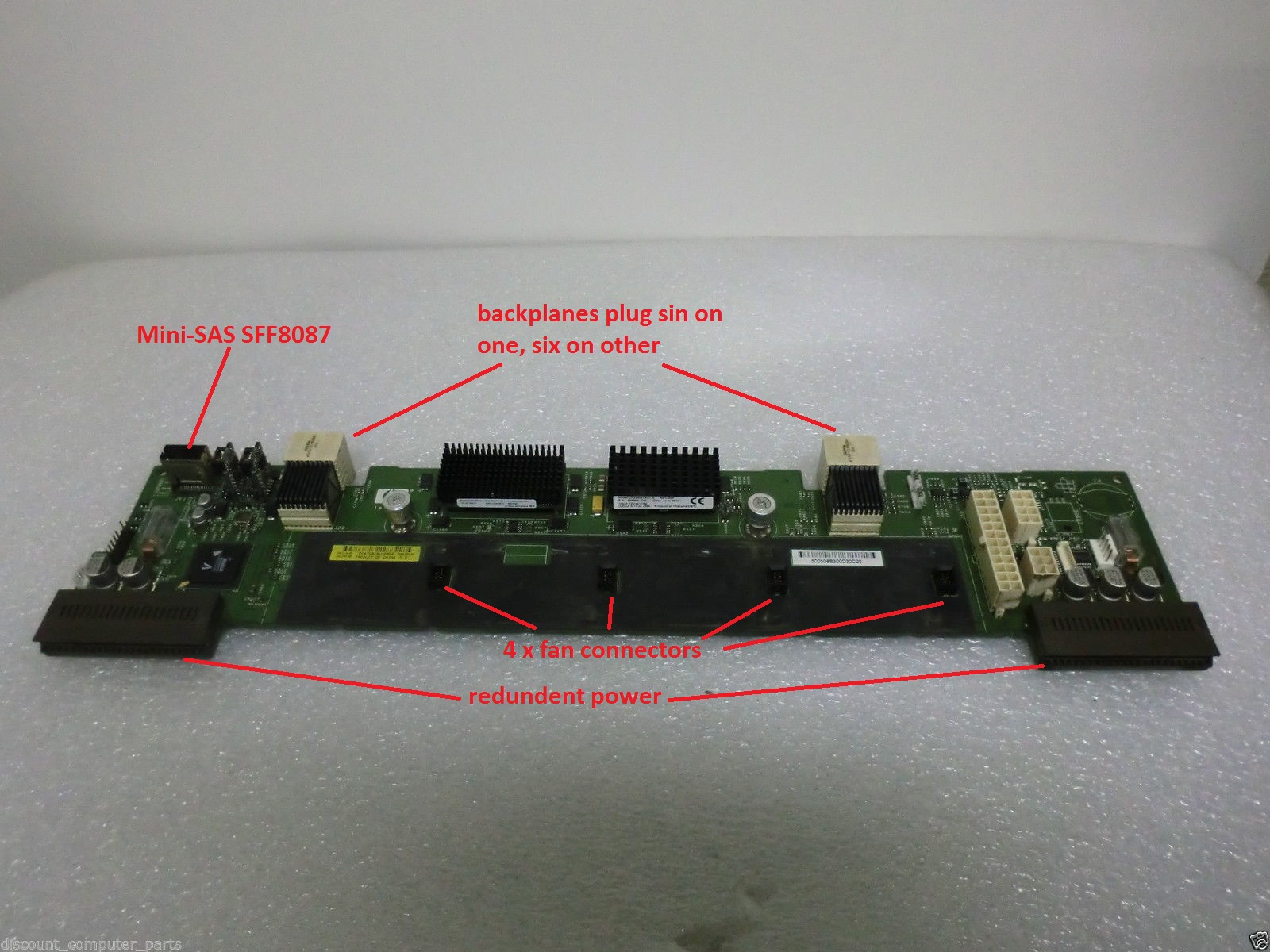

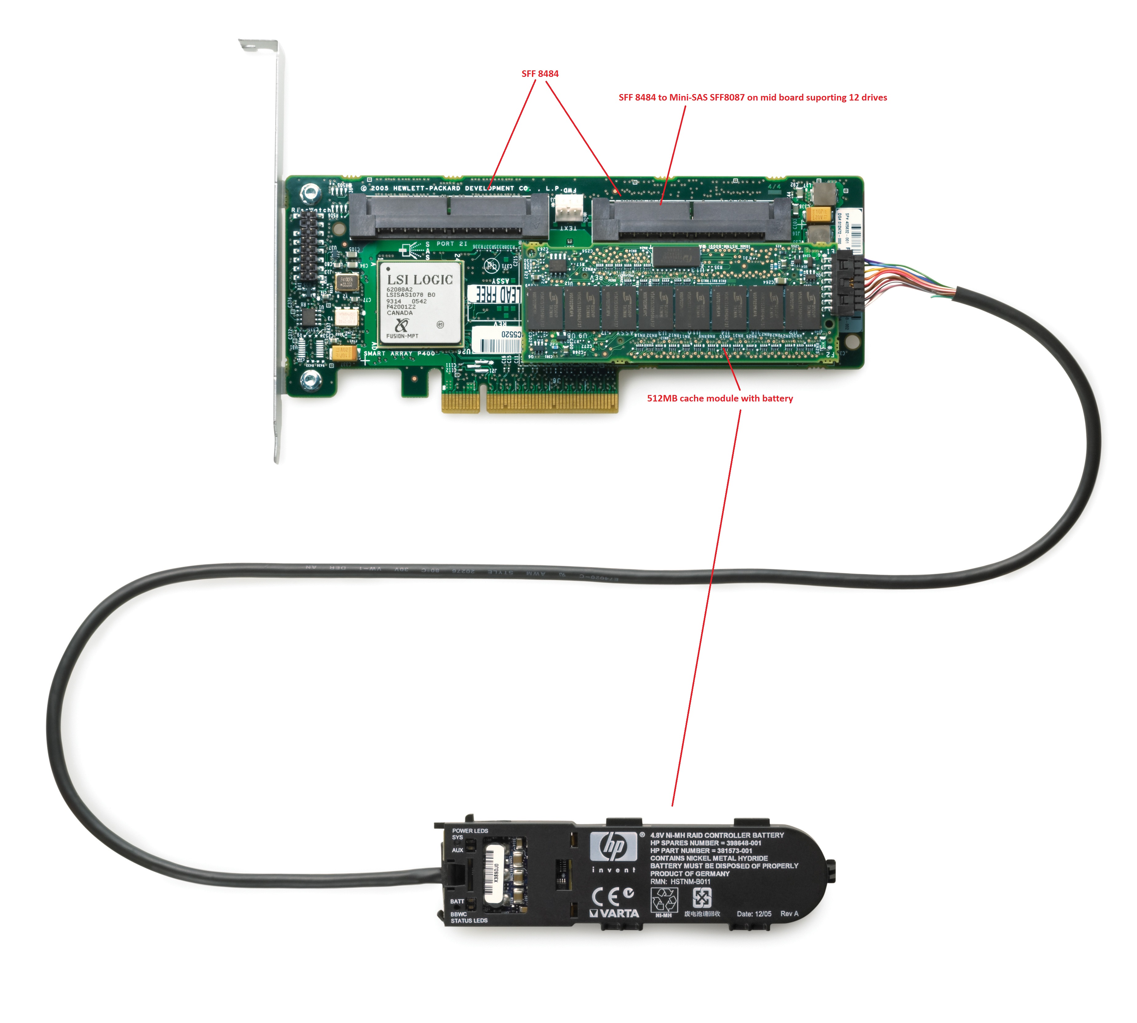

Hi sorry been a manic few weeks .... right the P400 2x SFF8484 connectors on it and the midboard that the backplanes connect to have a Mini-SAS SFF8087
Can i only asume that the midboard is a port multiplier?...
That's probably a fair assumption. You'll be bottlenecked a little from only one SAS connection, but it would be worse (I'm currently bottlenexed on an md1000 enclosure at about 500MB/s... makes parity checks slooooooow. I don't think you'll see much of an issue if you're only doing single writes/reads most of the time. And it's not like you have many other options to access those drives unless you get an external enclosure, at which point you'l either have to make a dual sas link or use an hba expander and live on a x4 bandwidth infiiband connection.
