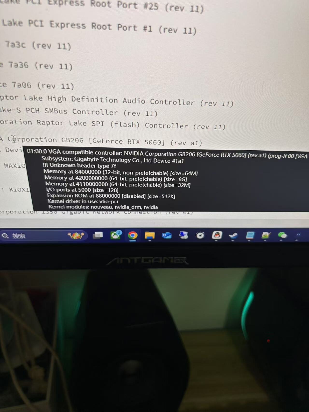

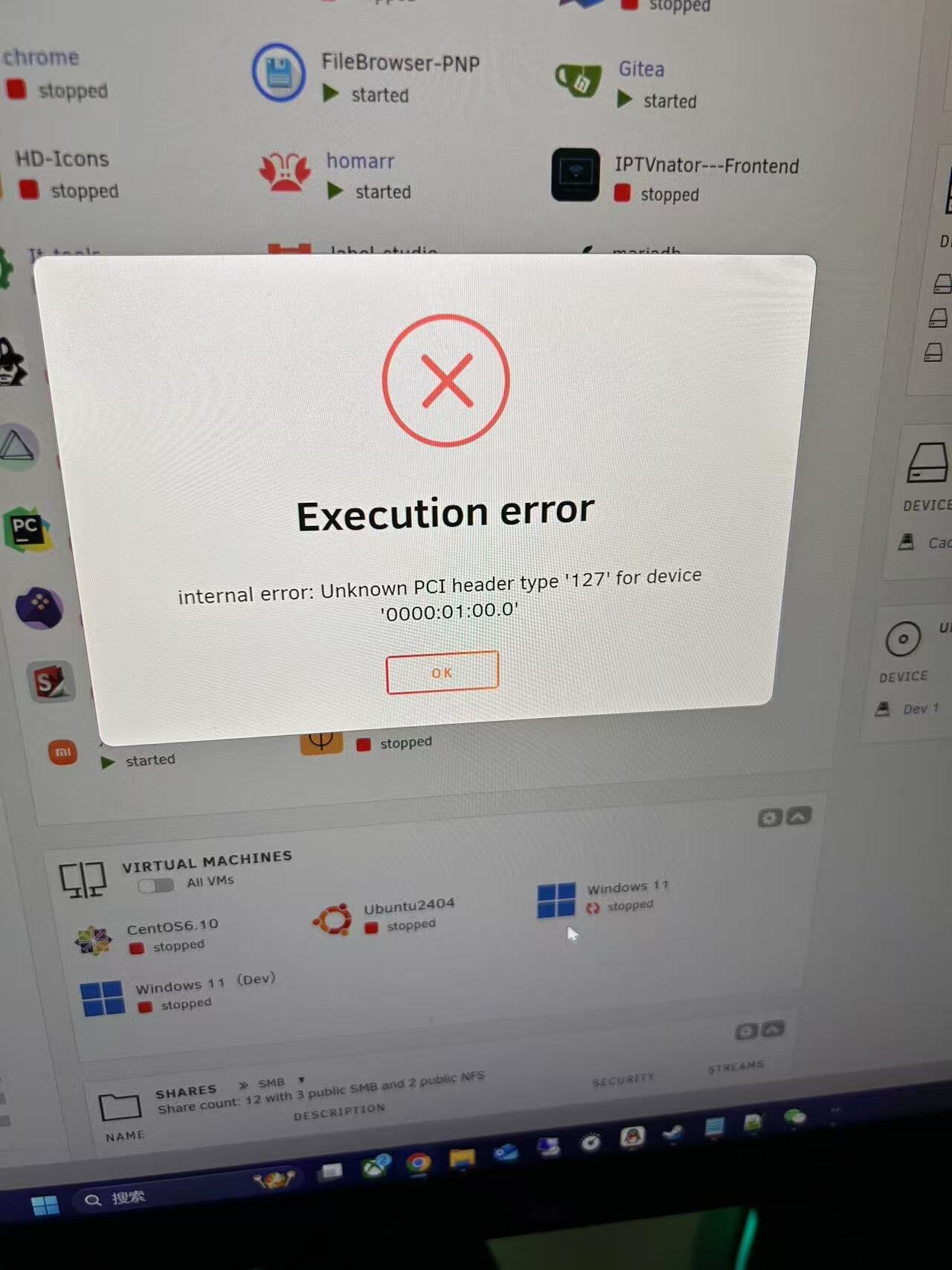

July 28, 20251 yr I recently replaced my GT 1030 with an RTX 5060 and now GPU passthrough fails — the VM won't even start.With the GT 1030, passthrough worked fine even without binding the GPU to VFIO (it passed through successfully regardless). However, with the RTX 5060, it simply doesn't work. I've double- and triple-checked my configuration, and when I swap back to the GT 1030, everything works normally again.Has anyone successfully passed through an RTX 5060 in Unraid? I'm wondering if there are known compatibility issues or special steps required for this card.I've already tried:Double-checking BIOS settings (Above 4G Decoding, SR-IOV, etc.)Ensuring IOMMU groups are properly set upUpdating Unraid to the latest stable version Edited July 28, 20251 yr by Yang0hui

August 13, 2025Aug 13 Community Expert Did you ever try to use this in the append line:vfio-pci.disable_idle_d3=1This will prevent the GPU to go to d3cold before even attempting to turn on the VM. My issue was I can't even open the VM because it automatically goes to d3cold which gives the unknow pci header type 127.I was able to run the VM but I am currently in black screen now. Let me know if you tried that one.
August 13, 2025Aug 13 Community Expert I was reading your log, you are at the same ditch as me, try adding that in your append line, it may start working.
August 14, 2025Aug 14 Community Expert Solution The problem:Unknown PCI Header type 127.Cause, according to SpaceInvaderOne, the reason this happens is when GPU is abruptly shutdown, the only way to fix this is to restart the server or use his script (which works btw).However, the problem remains when we run the VM and gives the same message again.Possible Solutions in Append line:vfio-pci.disable_idle_d3=1 # Prevent GPU power state issues - This prevents the D3cold state. ---- vfio-pci.ids=xxxx:xxxx,xxxx:xxxx # Bind your GPU + audio to VFIO video=efifb:off # Disable EFI framebuffer pcie_aspm=off # Disable PCIe power management pci=noats # Disable Address Translation Services intel_iommu=on iommu=pt # Enable IOMMU passthroughAfter adding the vfio-pci.disable_idle_d3=1 to the append line, this what it should look like if you run this in the terminal: dmesg | grep -i vfioroot@Punggokers:~# dmesg | grep -i vfio [ 0.000000] Command line: BOOT_IMAGE=/bzimage isolcpus=0-17 vfio-pci.ids=10de:2882,10de:22be vfio-pci.disable_idle_d3=1 video=efifb:off pcie_aspm=off intel_iommu=on iommu=pt initrd=/bzroot [ 0.088917] Kernel command line: BOOT_IMAGE=/bzimage isolcpus=0-17 vfio-pci.ids=10de:2882,10de:22be vfio-pci.disable_idle_d3=1 video=efifb:off pcie_aspm=off intel_iommu=on iommu=pt initrd=/bzroot [ 1.779123] VFIO - User Level meta-driver version: 0.3 [ 1.779152] vfio-pci 0000:01:00.0: vgaarb: VGA decodes changed: olddecodes=io+mem,decodes=io+mem:owns=none [ 1.779190] vfio-pci 0000:82:00.0: vgaarb: VGA decodes changed: olddecodes=io+mem,decodes=io+mem:owns=none [ 1.779223] vfio_pci: add [10de:2882[ffffffff:ffffffff]] class 0x000000/00000000 [ 1.779330] vfio_pci: add [10de:22be[ffffffff:ffffffff]] class 0x000000/00000000 [ 34.475709] vfio-pci 0000:01:00.0: vgaarb: VGA decodes changed: olddecodes=io+mem,decodes=io+mem:owns=none [ 34.475711] vfio-pci 0000:82:00.0: vgaarb: VGA decodes changed: olddecodes=io+mem,decodes=io+mem:owns=none root@Punggokers:~#This tells us that the GPU and Audio is properly binded and is now ready to be in a VM.The next problem you'll encounter is if you put your GPU + Audio as your primary GPU and Audio, and run the VM you'll probably get a BLACK SCREEN. type this in the terminal dmesg | grep -i vfio after running the VM and you should probably get the following below :root@Punggokers:~# dmesg | grep -i vfio [ 0.000000] Command line: BOOT_IMAGE=/bzimage isolcpus=0-17 vfio-pci.ids=10de:2882,10de:22be vfio-pci.disable_idle_d3=1 video=efifb:off pcie_aspm=off intel_iommu=on iommu=pt initrd=/bzroot [ 0.089377] Kernel command line: BOOT_IMAGE=/bzimage isolcpus=0-17 vfio-pci.ids=10de:2882,10de:22be vfio-pci.disable_idle_d3=1 video=efifb:off pcie_aspm=off intel_iommu=on iommu=pt initrd=/bzroot [ 1.769221] VFIO - User Level meta-driver version: 0.3 [ 1.769254] vfio-pci 0000:01:00.0: vgaarb: VGA decodes changed: olddecodes=io+mem,decodes=io+mem:owns=none [ 1.769293] vfio-pci 0000:82:00.0: vgaarb: VGA decodes changed: olddecodes=io+mem,decodes=io+mem:owns=none [ 1.769323] vfio_pci: add [10de:2882[ffffffff:ffffffff]] class 0x000000/00000000 [ 1.769451] vfio_pci: add [10de:22be[ffffffff:ffffffff]] class 0x000000/00000000 [ 34.399695] vfio-pci 0000:01:00.0: vgaarb: VGA decodes changed: olddecodes=io+mem,decodes=io+mem:owns=none [ 34.399697] vfio-pci 0000:82:00.0: vgaarb: VGA decodes changed: olddecodes=io+mem,decodes=io+mem:owns=none [ 404.394745] vfio-pci 0000:01:00.1: enabling device (0000 -> 0002) [ 405.546733] vfio-pci 0000:01:00.1: vfio_bar_restore: reset recovery - restoring BARs [ 405.546845] vfio-pci 0000:01:00.0: vfio_bar_restore: reset recovery - restoring BARs [ 406.266298] vfio-pci 0000:01:00.0: timed out waiting for pending transaction; performing function level reset anyway [ 407.426295] vfio-pci 0000:01:00.0: not ready 1023ms after FLR; waiting [ 408.514290] vfio-pci 0000:01:00.0: not ready 2047ms after FLR; waiting [ 410.626281] vfio-pci 0000:01:00.0: not ready 4095ms after FLR; waiting [ 414.850269] vfio-pci 0000:01:00.0: not ready 8191ms after FLR; waiting [ 423.554237] vfio-pci 0000:01:00.0: not ready 16383ms after FLR; waiting [ 440.450175] vfio-pci 0000:01:00.0: not ready 32767ms after FLR; waiting [ 476.290040] vfio-pci 0000:01:00.0: not ready 65535ms after FLR; giving up [ 476.572567] vfio-pci 0000:01:00.0: vfio_bar_restore: reset recovery - restoring BARs [ 476.572721] vfio-pci 0000:01:00.1: vfio_bar_restore: reset recovery - restoring BARs [ 476.584156] vfio-pci 0000:01:00.0: vfio_bar_restore: reset recovery - restoring BARs [ 476.584312] vfio-pci 0000:01:00.1: vfio_bar_restore: reset recovery - restoring BARs [ 476.593936] vfio-pci 0000:01:00.0: vfio_bar_restore: reset recovery - restoring BARs [ 476.594092] vfio-pci 0000:01:00.1: vfio_bar_restore: reset recovery - restoring BARs [ 476.599060] vfio-pci 0000:01:00.0: vfio_bar_restore: reset recovery - restoring BARs [ 476.599552] vfio-pci 0000:01:00.0: vfio_bar_restore: reset recovery - restoring BARs [ 476.605684] vfio-pci 0000:01:00.0: vfio_bar_restore: reset recovery - restoring BARs [ 476.605820] vfio-pci 0000:01:00.0: vfio_bar_restore: reset recovery - restoring BARs [ 476.605841] vfio-pci 0000:01:00.0: vfio_bar_restore: reset recovery - restoring BARs [ 476.605867] vfio-pci 0000:01:00.1: vfio_bar_restore: reset recovery - restoring BARs [ 476.605965] vfio-pci 0000:01:00.1: vfio_bar_restore: reset recovery - restoring BARs [ 476.605986] vfio-pci 0000:01:00.1: vfio_bar_restore: reset recovery - restoring BARs [ 476.606064] vfio-pci 0000:01:00.0: vfio_bar_restore: reset recovery - restoring BARs [ 476.606084] vfio-pci 0000:01:00.1: vfio_bar_restore: reset recovery - restoring BARs [ 476.615625] vfio-pci 0000:01:00.0: vfio_bar_restore: reset recovery - restoring BARs [ 476.615761] vfio-pci 0000:01:00.1: vfio_bar_restore: reset recovery - restoring BARs [ 476.620394] vfio-pci 0000:01:00.0: vfio_bar_restore: reset recovery - restoring BARs [ 476.620493] vfio-pci 0000:01:00.0: vfio_bar_restore: reset recovery - restoring BARs [ 476.620514] vfio-pci 0000:01:00.1: vfio_bar_restore: reset recovery - restoring BARs [ 476.620612] vfio-pci 0000:01:00.1: vfio_bar_restore: reset recovery - restoring BARs [ 476.640481] vfio-pci 0000:01:00.0: vfio_bar_restore: reset recovery - restoring BARs [ 476.640665] vfio-pci 0000:01:00.1: vfio_bar_restore: reset recovery - restoring BARs [ 476.708380] vfio-pci 0000:01:00.0: vfio_bar_restore: reset recovery - restoring BARs [ 476.708556] vfio-pci 0000:01:00.1: vfio_bar_restore: reset recovery - restoring BARs root@Punggokers:~# This will give us an FLR issue: The VFIO logs show that the GPU is having serious reset issues - it's failing to complete a Function Level Reset (FLR) and timing out after 65+ seconds.The solution, when you create a VM, only put the Primary Graphics Card, NO SOUND CARD, and it should run without a black screen and should boot properly. This may be a quirk of the consumer cards, but at least it should work.Warning: You need to have an iGPU on top of your primary GPU. I tried running unraid with one GPU, it will still give you a black screen. Make sure Unraid uses your iGPU or something else. Unraid must absolutely not use your VM GPU. Edited August 14, 2025Aug 14 by PUNGGOKERS

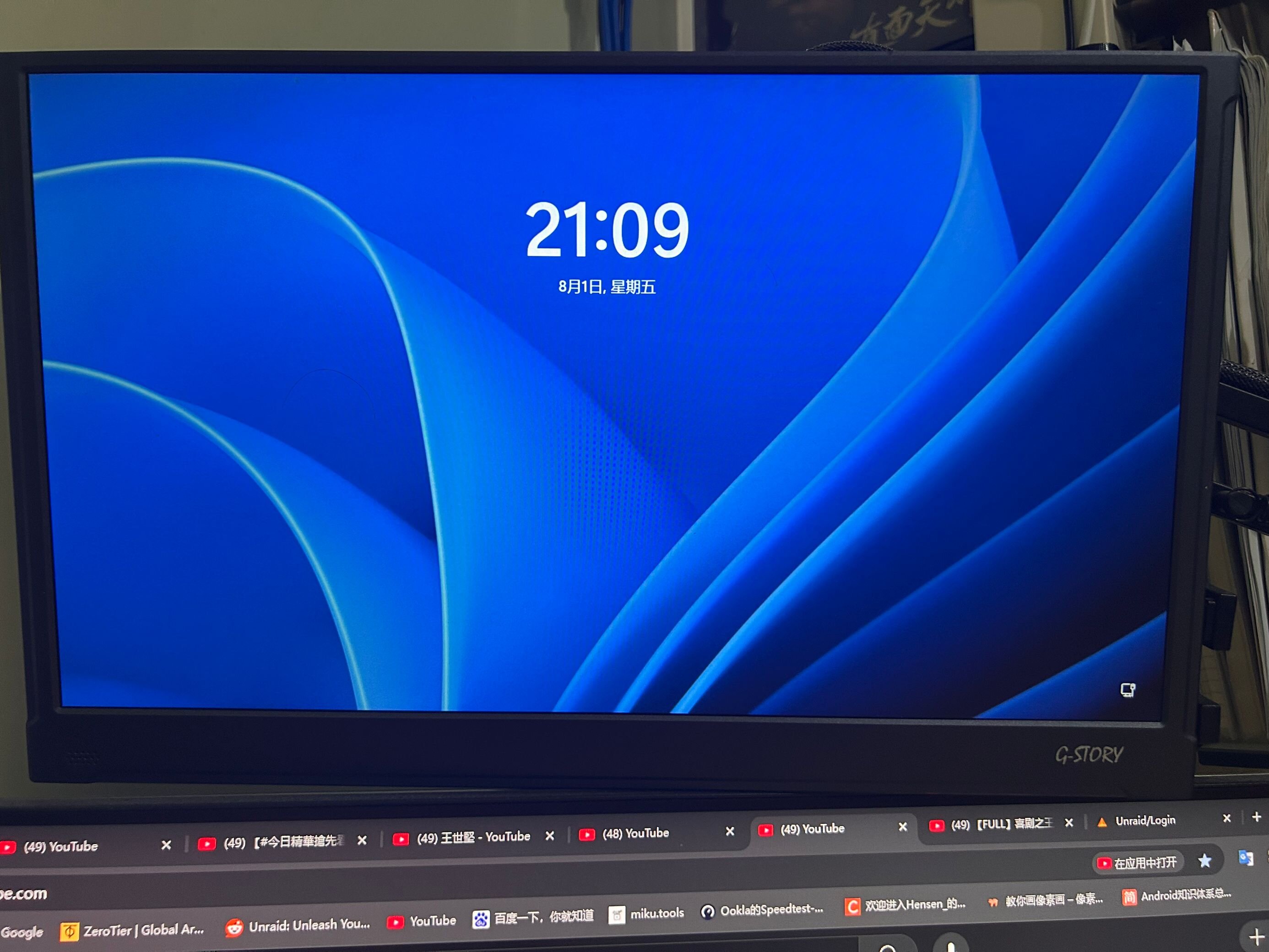

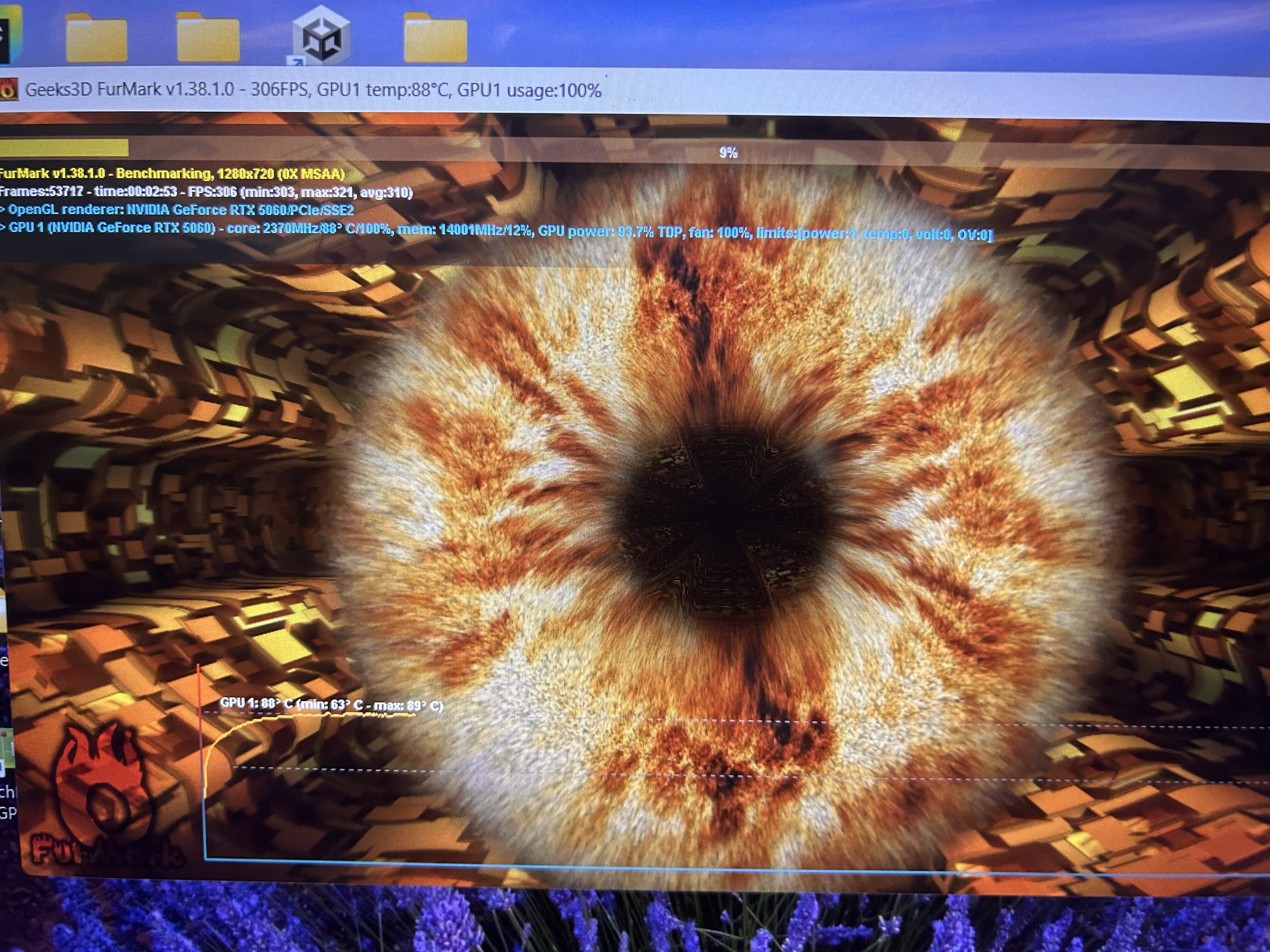

August 14, 2025Aug 14 Author 17 minutes ago, PUNGGOKERS said:Warning: You need to have an iGPU on top of your primary GPU. I tried running unraid with one GPU, it will still give you a black screen. Make sure Unraid uses your iGPU or something else. Unraid must absolutely not use your VM GPU.According to this guy's suggestion, I successfully passed through the GPU and got the VM up and running. Not sure if Unraid will officially provide a perfect solution to this issue
