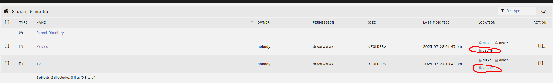

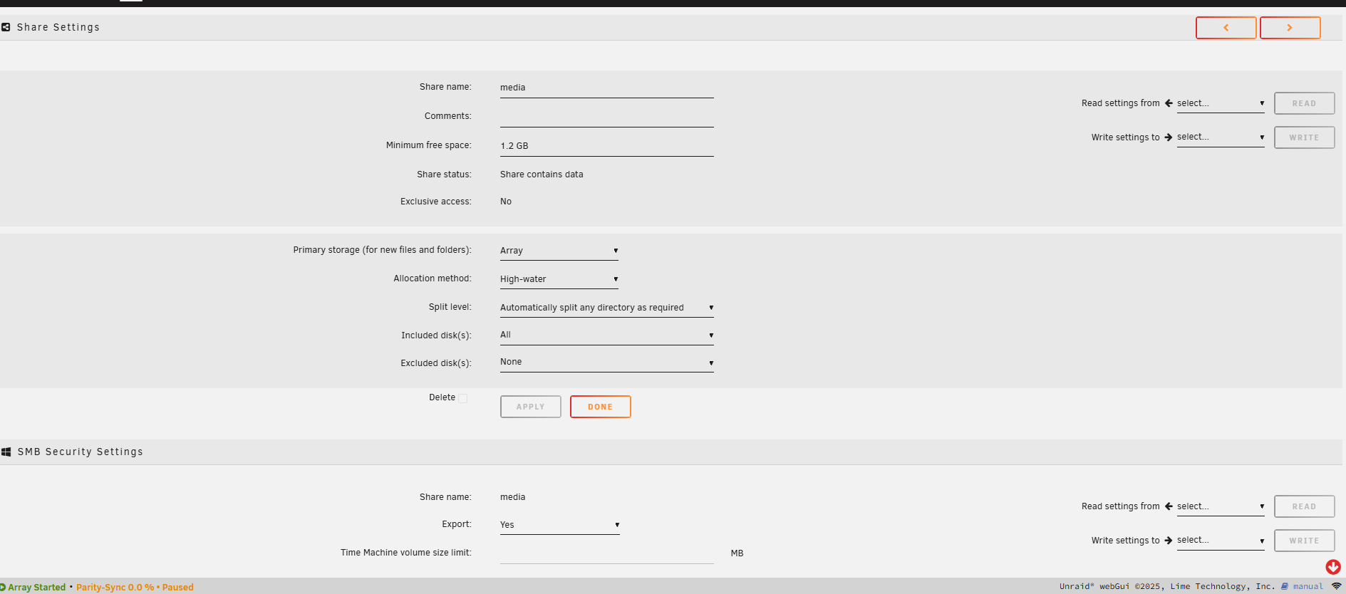

ok, one issue I'm seeing is that my cache has a /media folder, which shouldnt exist. it is full of all my downloads since setting up unraid a few days ago. This is whats filling up the drive. BUT my share setting for media has always been array for primary storage, and no secondary. Why is this happening?

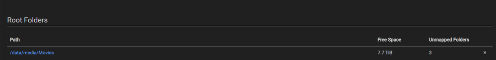

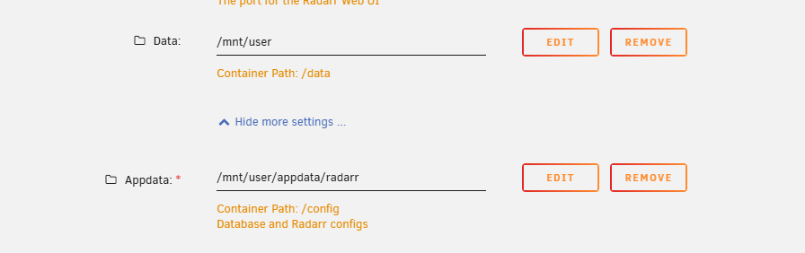

ok, this seemed to work!! Thanks for the tip - and I think you're right, radarr is likely putting them in the cache, but not sure why as I thought my setup is correct:

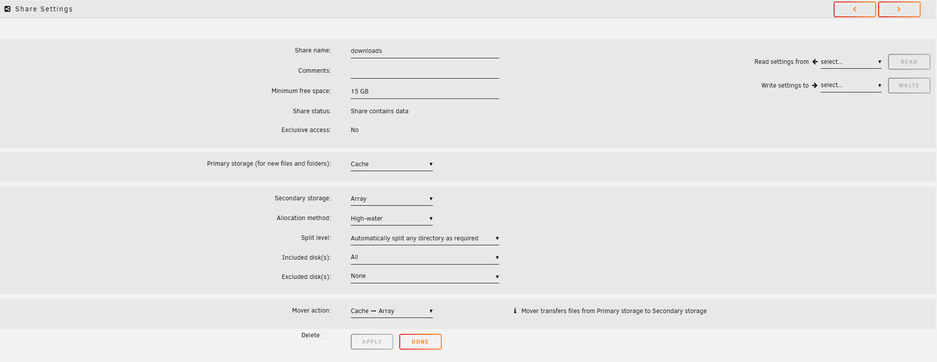

Then qbittorrent downloads to this on the cache:
