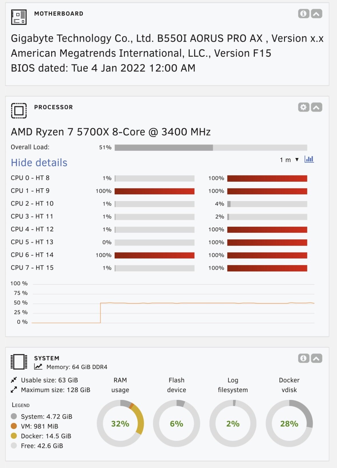

July 31, 2025Jul 31 This is an incomplete issue, I’m asking for help to further troubleshoot the problem. Recently my server has been having some intermittent issues where the dashboard reports 50% cpu utilisation, and all docker containers become unresponsive , even the shutdown commands do too.The only temporary method to resolve is to hard shutdown it down. Sometimes this will reoccur within a day, but sometime longer, I had a steak recently of 2 months, it fooled me into thinking all my problems were over.When sshd into the server, top reports normal utilisation, showing no major processes, with total utilisation no where near 50%. The kernel log also shows no messages related to this.Where can I look next to debug?

September 20, 2025Sep 20 Author So further debugging during an event, revealed the true cause of this behaviour is a lock of /mnt/user. As the containers mounted that for appdata, they froze. I tried moving them directly to /mnt/cache to prevent over use of the shfs, but that merely kept some containers alive when it happened again. What are some troubleshooting steps I could take? I have already updated to the latest release of unraid
