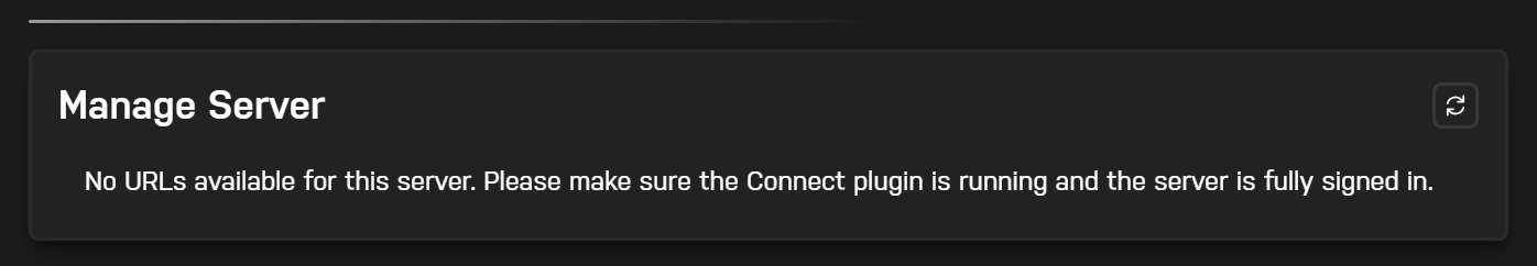

I find myself in a strange situation, after internet outage (Still no internet) I cant access my local UNraid UI on my loacal IP?
Is there any special settings I need to define when using the unraid connect and needing local access?
Example: If I go to my local IP:
http://192.168.0.6/ main
That would be translated to:
192-168-0-6.e7591da5b3c213bd7e17dc48d29fc9dcd1283498.myunraid.net:XXXX
Or is this a Unifi problem? I am using a Unifi UDM router?
And not provide any webpage, luckily I have a monitor to the server and I can access the UI from here
This might just be a stupid configuration issue, that never have been a problem because internet haven't been down :-)
(I have read similar posts but I am running a old Unraid I am on the latest off. version 7.1.4, and none of the posts have helped me)

Solved by Frank1940
in ident.cfg in the /config directory, there is this setting:
Changing it to "no" and rebooting should allow you to access the GUI using the IP address. (Or you could just wait for the Internet to come back up...)

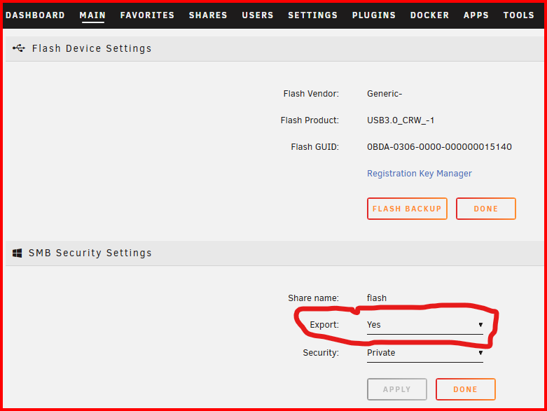

BTW: I have access through a master share, but I cant see the USB and config folder in that? Would would I have to do so I can edit and see that on the SMB share?
I share mine via the Flash Drive 'properties' page on the MAIN tab
Mine is configured to 'Private' and read-only. That allows me to get to easily access it to help people like you. 😉 (I don't like the concept of a 'Master' share. I want more control over who can do what to the contents of each individual share. Many of my shares are read-only even for me.)

Thanks! I already had it shared but it dosent show up un my "master pool shares" so I guess I have to map it by itself right?
So whats the share name: /Flash (Sorry cant see anything right now because of the missing WAN so its hit and miss :-)
UPDATE: Yes FLASH is it :-)
