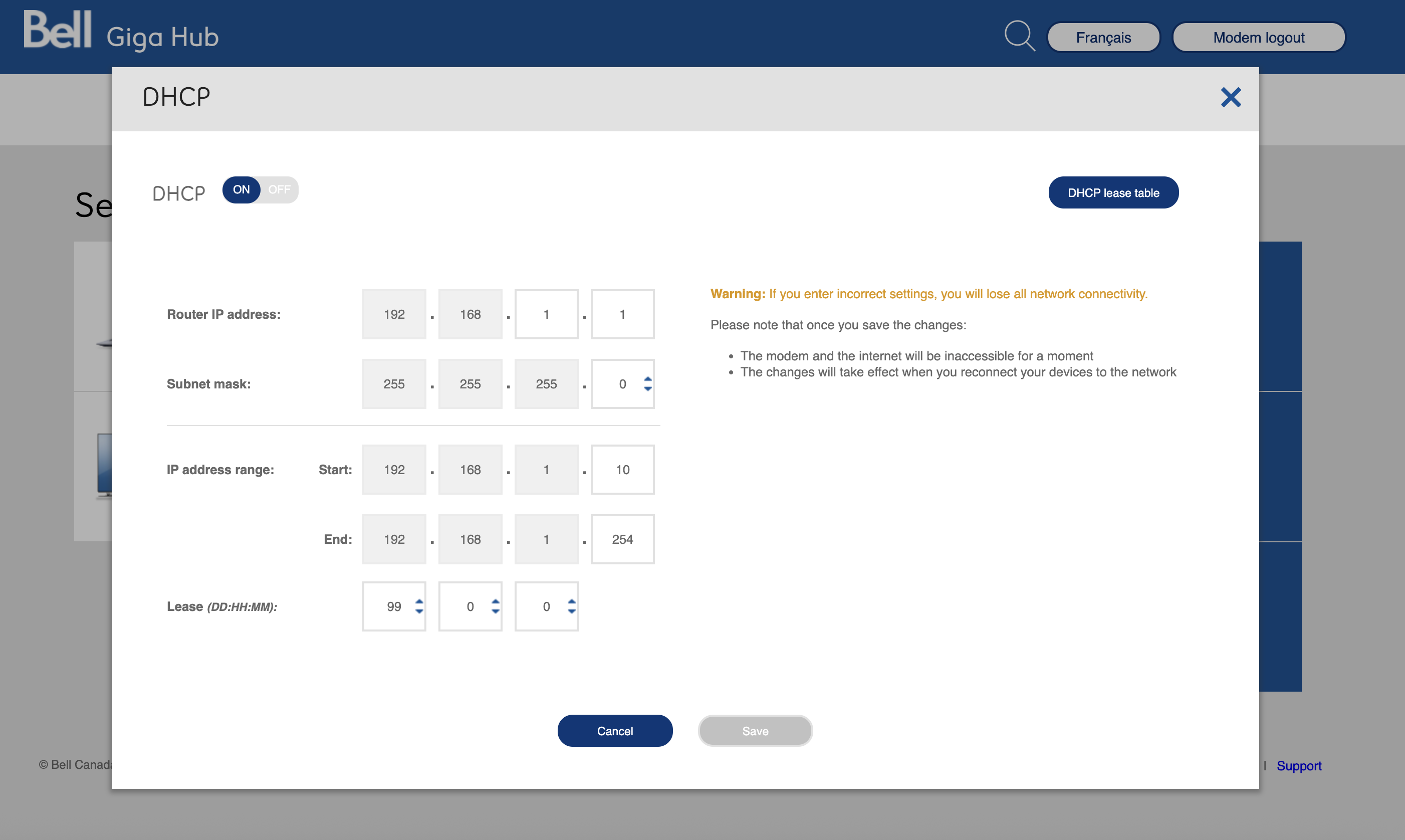

2) They supplied me with their Giga Hub Router. It's admin panel can be reached by entering 192.168.2.1 and this IP cannot be changed. That was confirmed by their techs

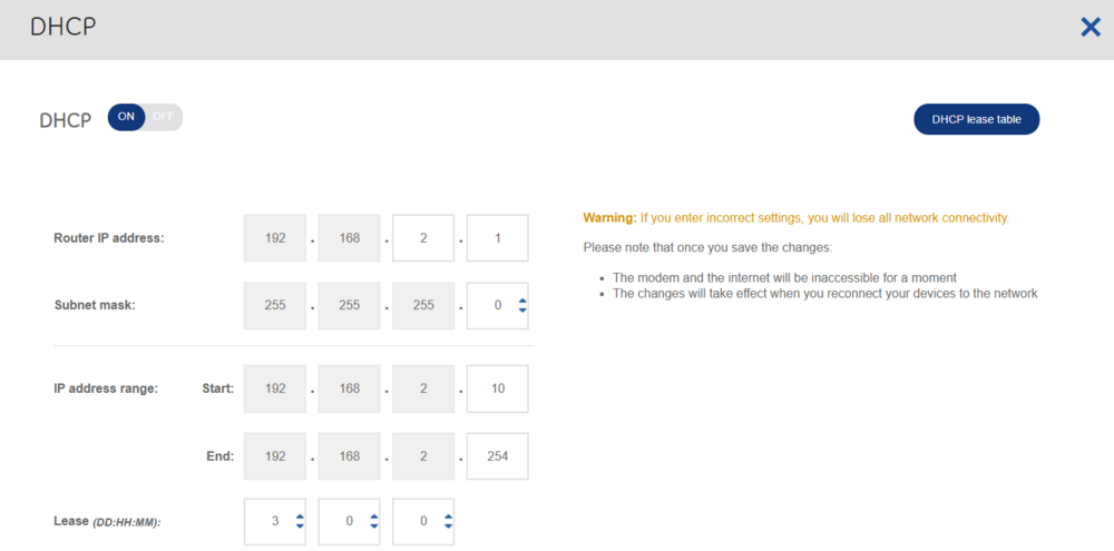

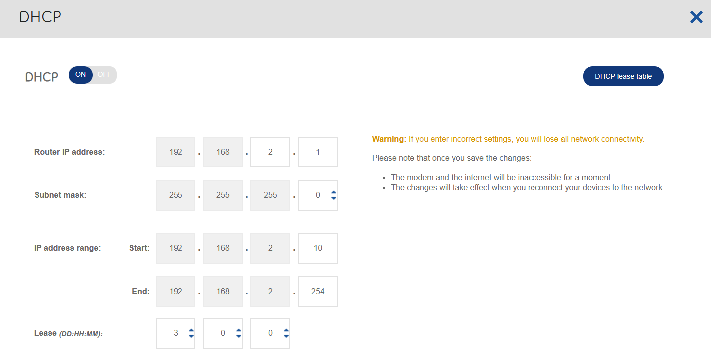

Inserted the UR USB into my laptop. Edited network.cfg (see screenshots for modded IP address 192.168.2.44)

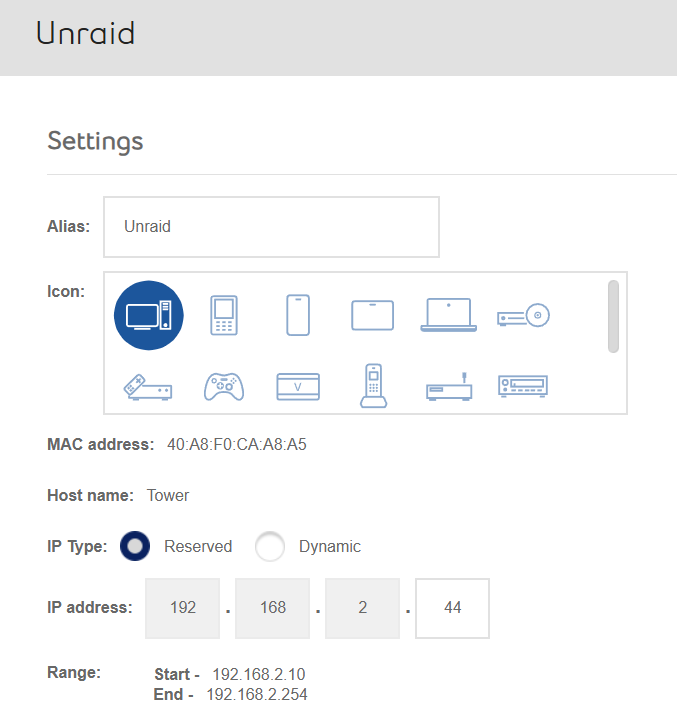

I entered the Giga Hub admin portal and reserved that IP

They lied. But, you are stuck with 192.168.x.x. Unless you upgrade to a business account

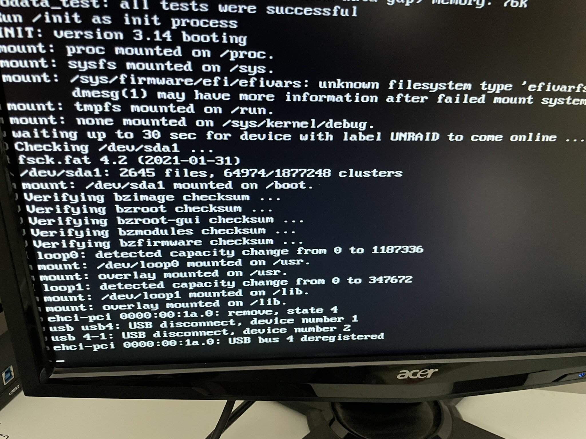

I have had a keyboard and monitor plugged into the server from the very start. Unfortunately, selecting Unraid OS GUI mode changes nothing for me. It hangs at that last line that you may or may have not seen in the screenshots that I provided in my original post. That's abnout as far as I am able to go

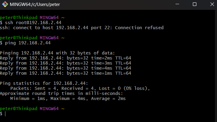

I have tried every boot combination available to me but nothing changes. I can ping 192.168.2.44 but cannot ssh into the box. Yes every unit has a Bell Giga Hub Modem. And, every room in our unit has RJ45 and coax wall plates at our disposal. I suppose they wanted to cover all bases in the event that they jump the Bell ship and move over to cable at some point.
I have another Lenovo TS-140 ThinkServer that I just started up and can access that machine without issue. I'm stumped.
Is there some way that I can bring up the cli upon first boot?
I also forgot to mention that I have had Tailscale running on the server for a while now. As is the case on all of my devices. Normally I would see the UR server's TS status as Connected when logging into the Tailscale admin portal. Clearly it is not.
