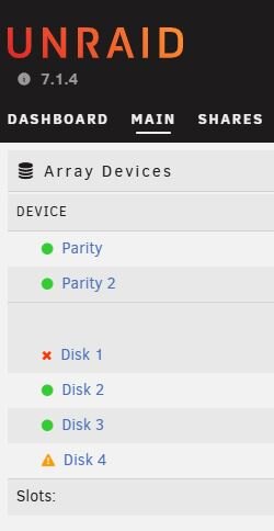

I can't start it though as these are my options. Note, I did not reboot or power cycle the server.
Did you change any assignments? You cannot change anything after the parity copy completes; there should have been an option to start the rebuild, it won't start by itself.

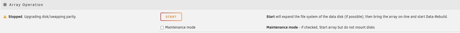

After the parity copy complete, the array status should look like this:
And the star button should be enabled for the rebuild:
I did change before I started. However, I just woke up and refreshed the page, so no I did not change anything since this last try.
I think the only option now is to start again for a 3rd try? Maybe I should reboot first in case there is some bug going on?
Should not be needed, but it won't hurt.
So for the 3rd time, I rebooted and it did give me the start option after the parity-upgrade! So it's rebuilding now finally. Thanks for your help.image.pngimage.png
