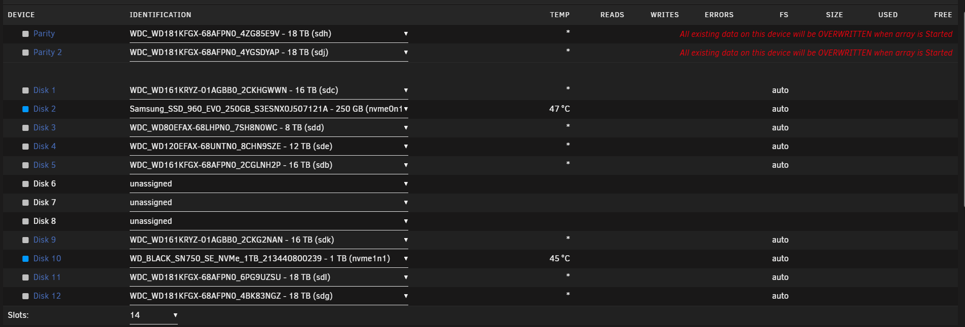

August 5, 2025Aug 5 I need some help. The backstory is a bit long but I want to explain this as detailed as possible. I also attached the Diagnostic file.I am in the process of upgrading to a larger USB flash drive so I can upgrade to a new version of Unraid (I've been stuck on 7.0 because my USB drive didn't have enough space). I also had 2 older drives that were throwing errors so I replaced them with 1 larger drive.I have 2 Parity Drives and 8 HDDs in my array. Disk 6 (8 TB) and Disk 7 (8 TB) were the old drives throwing errors so I replaced it with Disk 8 (16 TB). The new drive is brand new. A few weeks ago I transferred all the data from Disk 6 and Disk 7 to Disk 8 uneventfully.On 8/2, I backed up my old USB boot drive and migrated it into a largest USB drive. It all went well and booted up fine. Then out of nowhere, Disk 8 and Disk 12 both were disabled because it was in an error state. Unraid showed that both drives were being emulated. I checked the cables and reattached them and then I unassigned Disk 8 and Disk 12 and reassigned it. During the Parity Rebuild, Disk 8 showed as disabled again and the Parity rebuild stops. I unpause Parity Rebuild and let Disk 12 finish.Today (8/4), I change the SATA cable for Disk 8 and reboot the server. For some reason, Disk 8 shows up under "Unassigned Disk Devices". THIS IS WHERE I MAY HAVE MESSED UP... I went to New Config and selected ALL of "Preserve current assignments". This is when I see the "All existing data on this device will be OVERWRITTEN when array is Started". Realizing that I messed up I stopped and haven't touched the server since then and the array is off. I believe the data for Disk 8 is still on the Parity drives.Is there anyway to undo the New Config? I still have my USB Flash Drive Backup from before I changed the USB drive. Can I use that backup to go back to my old Config? Thank you in advance! leungunraid-diagnostics-20250804-2129.zip

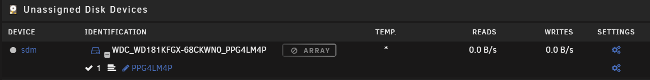

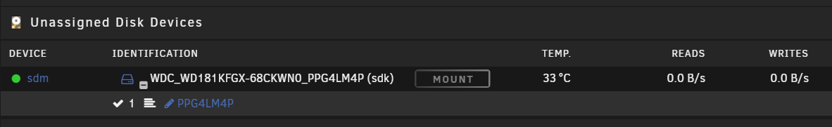

August 12, 2025Aug 12 Author I just got chance to try mounting the disk in question (Disk 8). It wouldn't let me. I assume it's because it's part of the array. I see an option to Change Disk Mount Point. Should I do this?Thanks
August 12, 2025Aug 12 Author I believe so. It's no longer mounted in the array. Please see screenshot belowThanks!
August 12, 2025Aug 12 Author Just rebooted. I was able to unassign it. The Mount option shows up now but it's greyed out.Thanks again for your help I appreciate it.

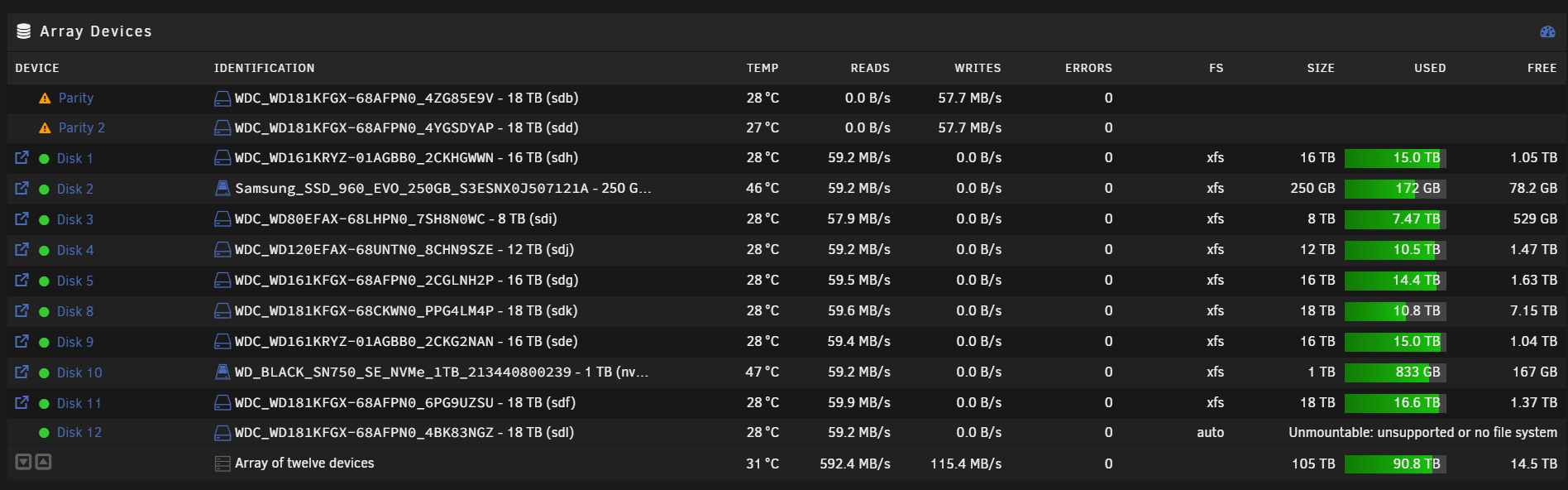

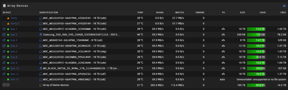

August 16, 2025Aug 16 Author I have no idea what's going on.... I started the Array and the Parity Sync began, but then I noticed that Disk 12 is showing the "Unmountable: unsupported or no file system" error.Do I need to complete the same procedure and XFS repair for Disk 12 as well?Thanks
August 17, 2025Aug 17 Author I think I'm good now. I ran the XFS Repair from the GUI. Parity is now Syncing. Thank you all!
