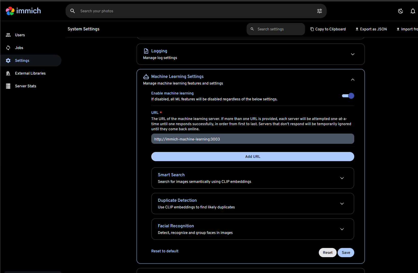

August 5, 20251 yr Community Expert if you can login to immich you will need to login with teh administrator account.go to settings and machien learnign:here you can edit the URL and set that to http://10.10.50.41:3003
