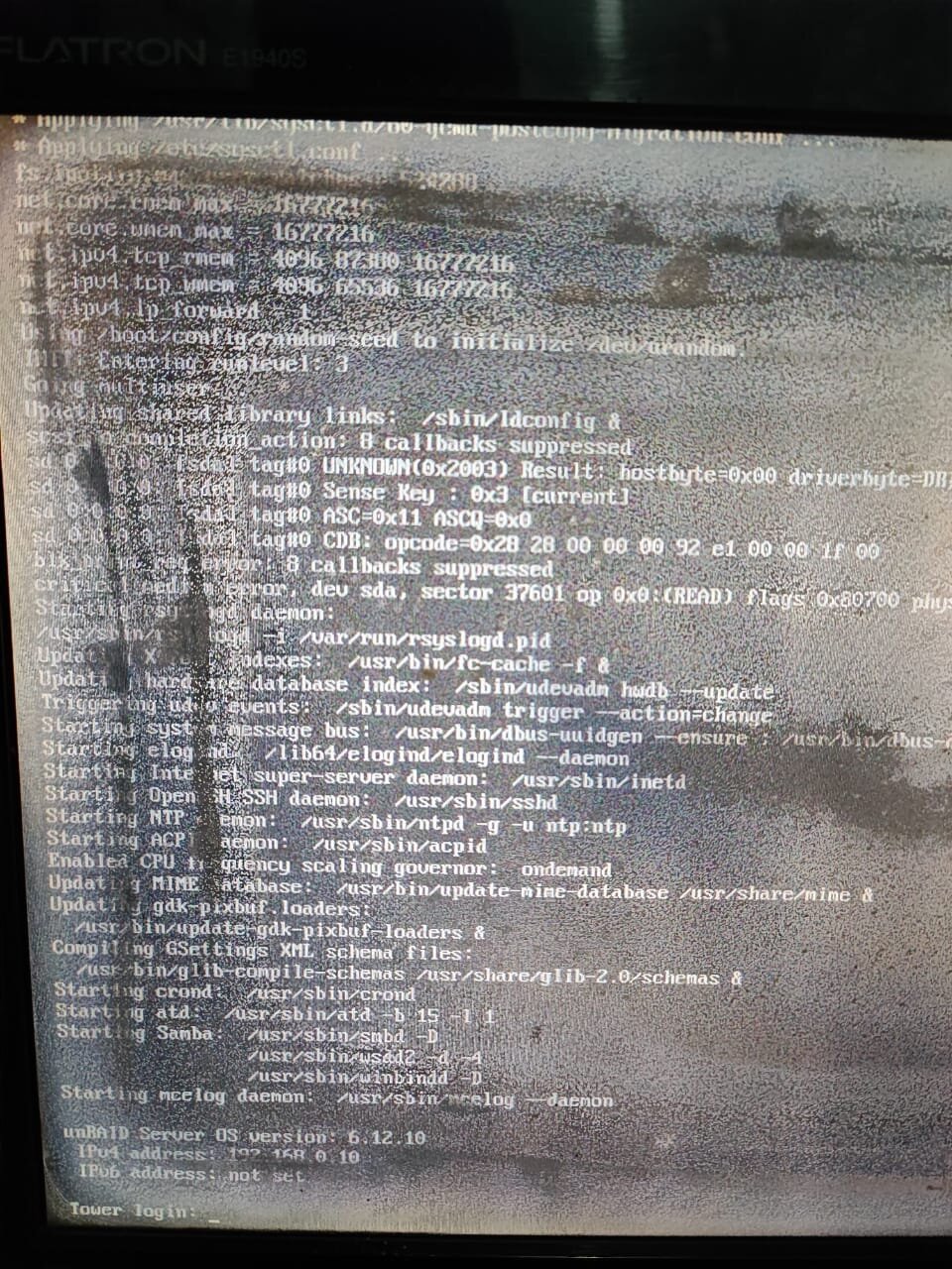

August 6, 2025Aug 6 Subject: Cannot Access Unraid WebGUI – Flash Drive Not RecognizedHello,I’m currently unable to access my Unraid server. Here are the details:WebGUI is not accessible at IP 192.168.0.10 – I get an error: ERR_CONNECTION_TIMED_OUT.The server boots to the screen shown in the attached image (console output ends with “Tower login:”).I cannot generate or download any diagnostic reports because the WebGUI is unreachable.I tried removing the USB flash drive and connecting it to a Windows PC, but it is not detected at all.This is the only thing i can share whern plug my monitor to my serverCould someone please help diagnose what might be happening and suggest a solution?Thank you.net.core.wmem_max = 16777216ipv4.tcp_rmem = 4096 87380 16777216ipv4.tcp_wmem = 4096 65536 16777216ipv4.ip_forward = 0/boot/config/random-seed to initialize /dev/urandomEntering runlevel: 3Unpacking required library links: /sbin/ldconfig &udevd-event[1326]: run_program: '/lib/udev/firmware.sh' abnormal exitend_request: I/O error, dev sda, sector 37601Buffer I/O error on device sda1, logical block 4700Starting syslogd daemon: /usr/sbin/syslogd -m 0Starting klogd daemon: /usr/sbin/klogd -c 3Starting inetd: inetdStarting OpenSSH SSH daemon: /usr/sbin/sshdStarting NTP daemon: /usr/sbin/ntpd -g -u ntp:ntpStarting ACPI daemon: /usr/sbin/acpidEnabling CPU frequency scaling governor: ondemandUpdating MIME database: /usr/bin/update-mime-database /usr/share/mime &Compiling GSettings XML schema files/usr/bin/glib-compile-schemas /usr/share/glib-2.0/schemas &Starting atd: /usr/sbin/atdStarting Samba: /usr/sbin/smbd -D /usr/sbin/nmbd -DStarting mcelog daemon: /usr/sbin/mcelog --daemonUnraid Server OS version: 6.12.10IP address: 192.168.0.10IPv6 address: not setTower login:
August 6, 2025Aug 6 Community Expert 45 minutes ago, manuelbudijono said:I cannot generate or download any diagnostic reports because the WebGUI is unreachable.You can get the diagnostics from the CLI, see the link.
August 6, 2025Aug 6 Author 58 minutes ago, JorgeB said:You can get the diagnostics from the CLI, see the link.I cannot access my usb drive when i plug it in to PC/windows...
