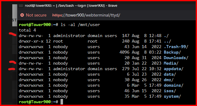

Open up the WebGUI terminal. Post up the output of this command:
ls -al /mnt/user
In your diagnostics, I count twelve shares that have been named but have no data stored in them. In the output of the command I asked you to run, do you see all the shares that you expected to find?

21 minutes ago, scythe944 said:
Was this with the array started in normal mode?
Yes, sorry. Was replying back to itimpi about the disk checks. After starting the array the command shows:
The directories marked with a 'tic' have definate problems!
Unless the execute permission bit is set, a normal user can not see inside the directory. Plus, the two directories with the administrator/domain as the owners/group S/B nobody/users. You need to determine what is changing these permissions and resetting the owner/group. (These are set as I indicated every time Unraid is booted up.)

Well, that's certainly odd then. Anyway to reset permissions back to normal? I don't have anything crazy installed on UNRAID, no VM's, just some docker containers.

Don't bother trying to reset the permissions. A reboot will restore them to the defaults.
Thanks Frank1940, I took a look at the thread that you referenced, I believe all of my docker containers were obtained through the community apps and are docker aware. I didn't modify any permissions manually and the PUID and PGID's appear to be 99 and 100, as the defaults reference. Just not sure why the shares aren't showing up anymore. Well, obviously, we know why, because the groups don't have access permissions anymore, just don't know what took them away.

I missed that you were joined to a domain. Not sure what the permissions/owner are supposed to be for those; leave the domain for now and change to workgroup, reboot, and post once more the output from
ls -la /mnt/user
ls -la /mnt/user
I just reverted back to a workgroup and selected the shares to be shared out with Work Group instead of Domain and did the command again:
When viewing docker logs for Plex and PostgreSQL_Immich, I have errors about not having permissions still:
Thanks for the help so far though
Did a new Permissions on the Media and Appdata shares after the Shares became available again and showed up (removing from Domain and setting shares to workgroup seems to have brought them back).

After doing the two permission reset on Appdata and Media, this is the current status of the ls -la /mnt /usr command:
Had to delete the Codec folder from Plex so that it could re-create the folder and download the codecs in order to play media, but at least it's working again.
They look OK, but note that resetting the permissions for the files inside the Appdata share can break the containers (correcting them for the folder itself is OK)
