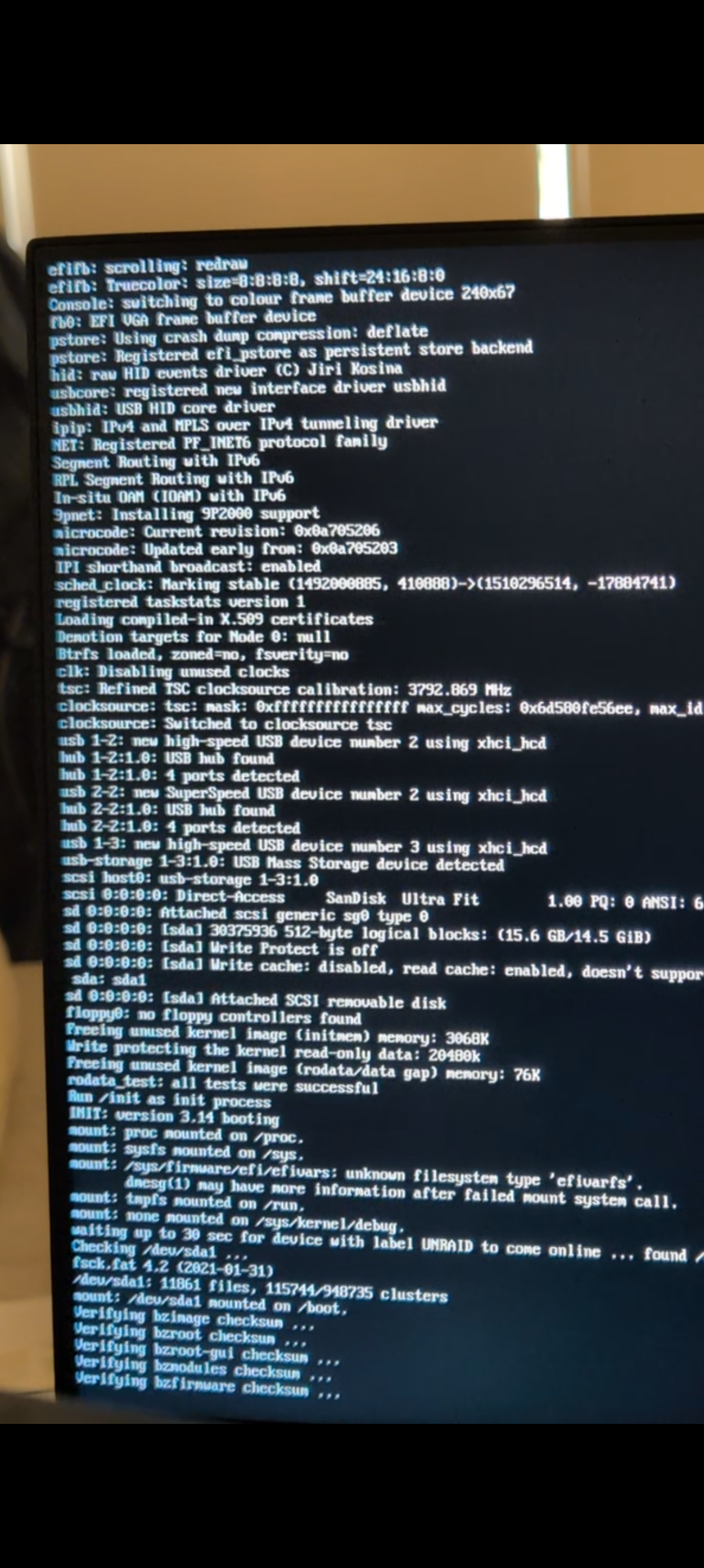

I put my PSU back in my case and unraid failed to boot with the following
From the above my USB is detected as sda but not loading the EFI folder. Further down neither SATA drives nor IPv4 address is assigned. This is similar to the following pages:

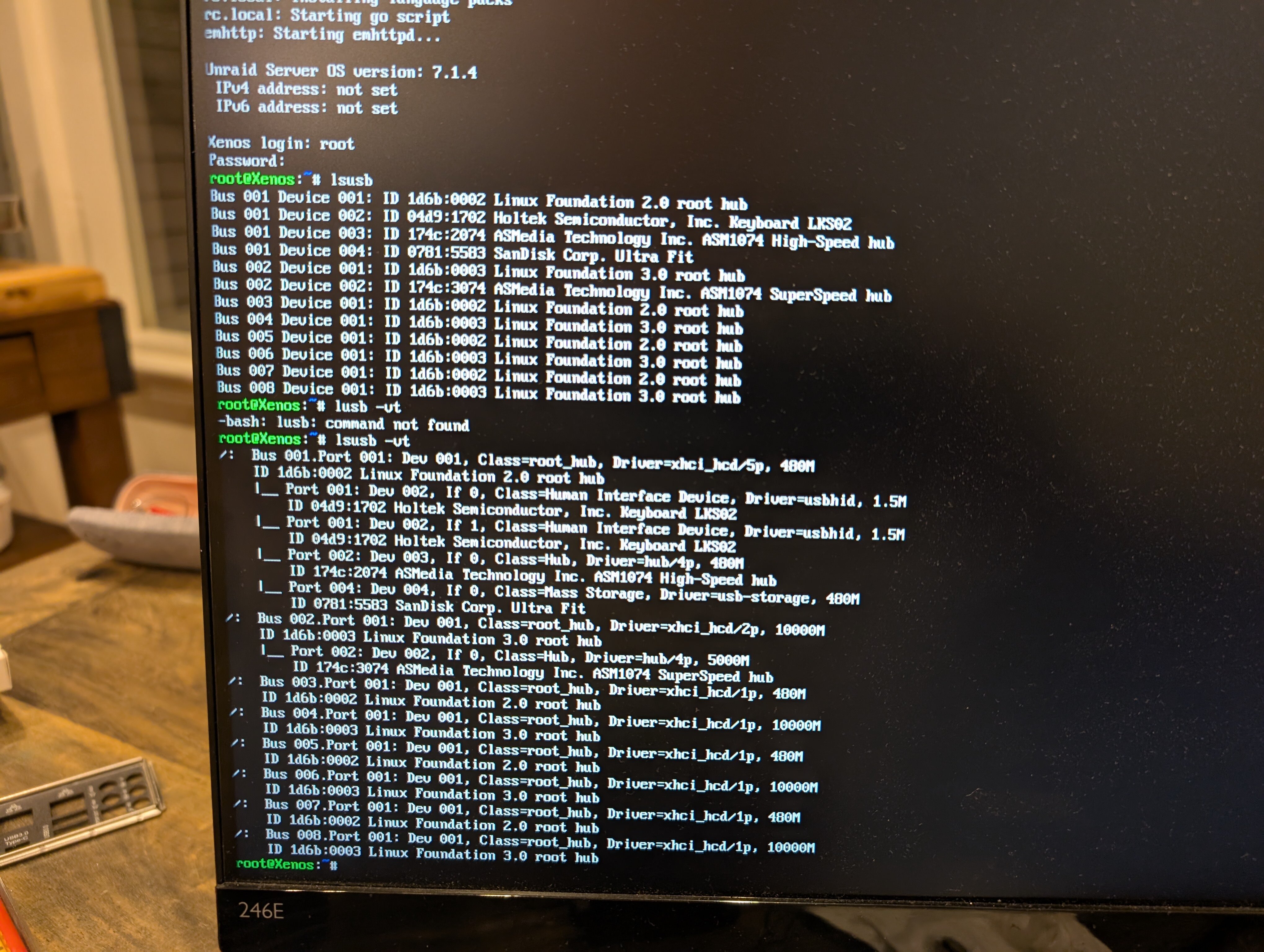

I did log in locally and the lsusb command results are below:

You can ignore this: Fail to boot with mount: /sys/firmware/efi/efivars: unknown filesystem type 'efivarfs' error, it's normal with 7.1.x and not the issue.
Try recreating the flash drive, first backup the current one, then recreate it using the USB tool, confirm the flash drive boots with the stock install, and if yes, restore only the /config folder from the backup overwriting any existing files.
