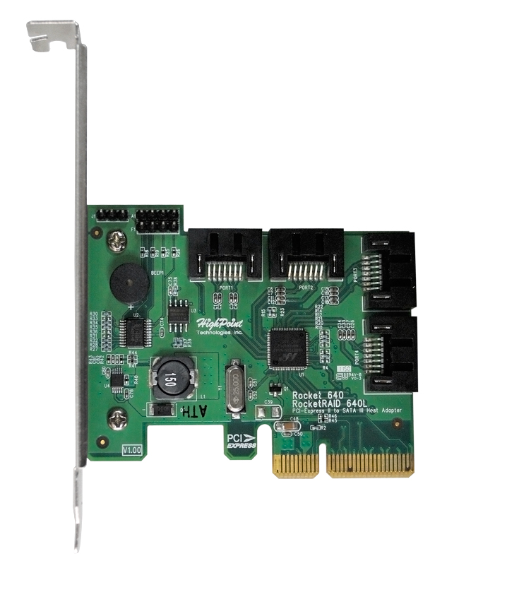

July 15, 201313 yr Mine says V1.0 and uses a Marvell 88SE9230. It is also screen printed with both "Rocket 640L" and "RocketRAID 640L" (see pic) which is interesting... the box just says Rocket. The difference seems to be support for RAID 0/1 vs 0/1/5/10/JBOD, and I have seen suggestions elsewhere that the RocketRAID 640L actually uses a 88SE9235. If true, then I do indeed have a Rocket 640L. Highpoint website suggests that there is now a "2nd Gen" version of the card (however is only ever referred to as "RocketRAID"), and which is again reported to use a Marvell 88SE9235. I note in some of the links in your sig that you are/were using a RR620 (not a 640) with a patched kernel and script to enable support for Marvell 88SE9128, however my 640L uses a Marvell 88SE9230 Would be good to know what card, version and chip you have, as well as how many drives/which ports you are using!
