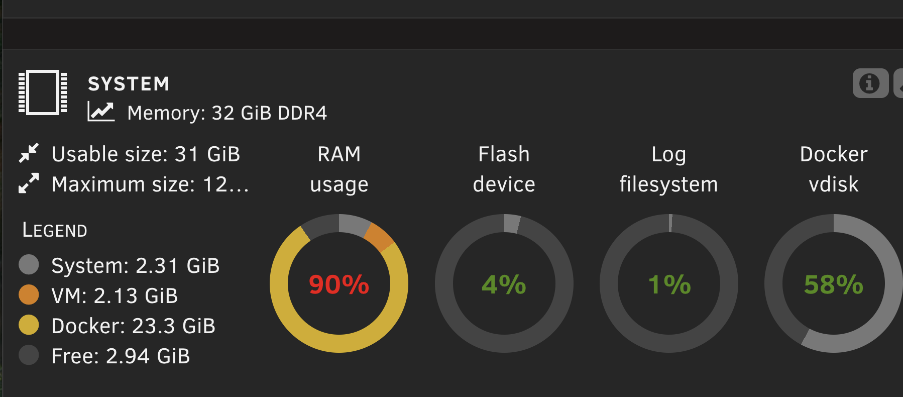

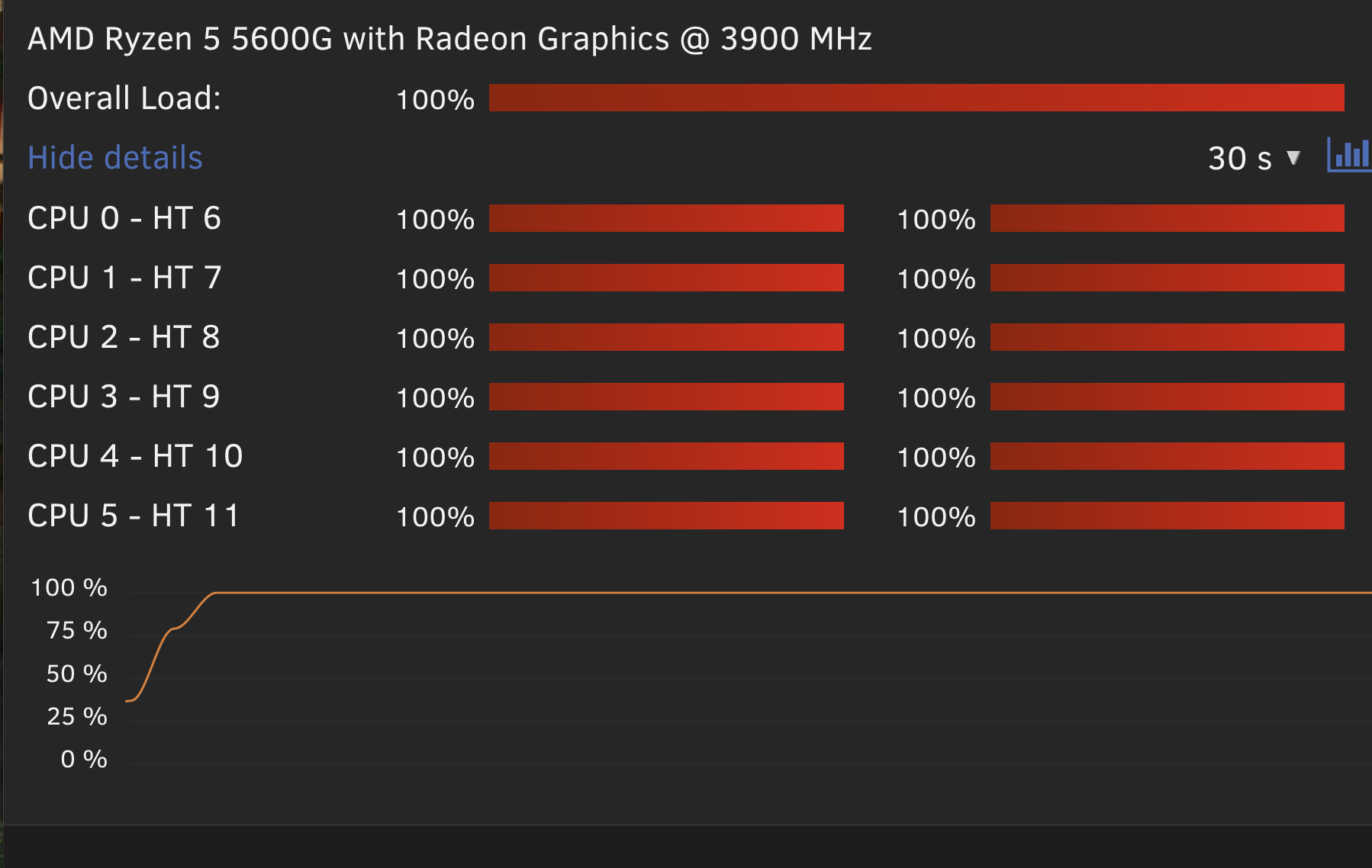

August 11, 2025Aug 11 I have created a new unRaid USB flash drive (sandisk Blade 32gb) as i am having problems with unRaid not loading properly the disk are freezing and noisy. I have no idea what the problem is and where to begin looking.When booting up unRaid it takes a while to load the docker (10 approx) on the latest attempt all the core where at 100% and ram at 90% See screenshots. I am not able to obtain diagnostic file due to the system freezing.
August 11, 2025Aug 11 Community Expert Does the same thing happen if you boot with Docker disabled? Also, post the diagnostics.
August 11, 2025Aug 11 Community Expert It could also be worth trying booting in Safe Mode to see if it is a plugin that is causing the problem as that mode disables loading plugins.
