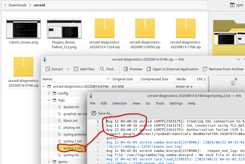

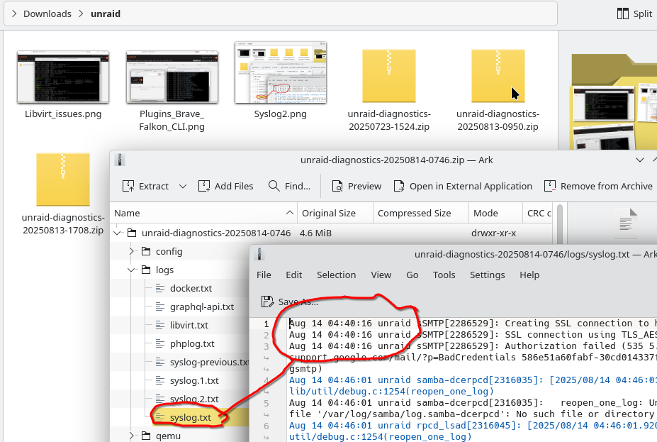

August 13, 20251 yr Community Expert The syslog already rotated; reboot and post new diags after array start.
August 14, 20251 yr Author Here's another diag, post reboot, just after array starts.unraid-diagnostics-20250814-0746.zip
August 14, 20251 yr Community Expert 1 hour ago, molasses2 said:They are, though. After a full power cycle, in fact.They are not, syslog starts on Aug 9 04:40:16, and it had already rotated.And the last ones are the same, they also start on:Aug 12 04:40:16 unraid sSMTP[2163179]: Creating SSL connection to hostAug 12 04:40:16 unraid sSMTP[2163179]: SSL connection using TLS_AES_256_GCM_SHA384
August 14, 20251 yr Author I don't see what you're seeing. I see Aug 12 in the syslog2.txt file, but syslog.txt shows Aug 14. I opened syslog.txt and attached it separately. I don't know what else to try.syslog2.txtsyslog.txt syslog.txt
August 14, 20251 yr Community Expert Syslog2 and syslog1 should never exist on a fresh boot; those are only created when the syslog rotates. You are either not actually rebooting the server or posting the wrong diags, check the server uptime

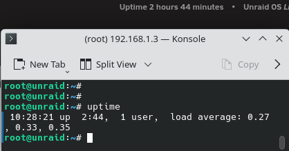

August 14, 20251 yr Author Maybe you've found something new that's also broken. As I mentioned, I have both rebooted and power cycled this server. Current uptime is 2h44m.
August 14, 20251 yr Community Expert I don't see how that is possible, but stranger things have happened. Post the output fromls -l /var/log/sys*
August 14, 20251 yr Author root@unraid:/boot/logs# ls -l /var/log/sys* -rw-r----- 1 root root  165482 Aug 14 11:33 /var/log/syslog -rw-r----- 1 root root 7185224 Aug 14 04:40 /var/log/syslog.1 -rw-r----- 1 root root 2568418 Aug 13 04:40 /var/log/syslog.2 root@unraid:/boot/logs#

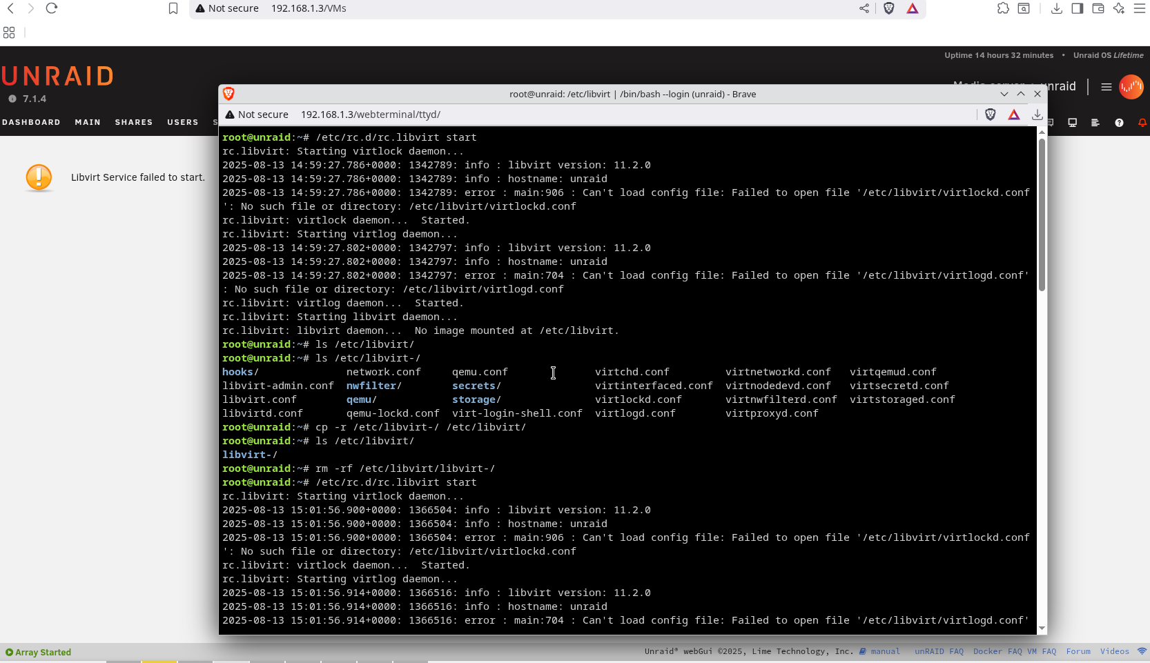

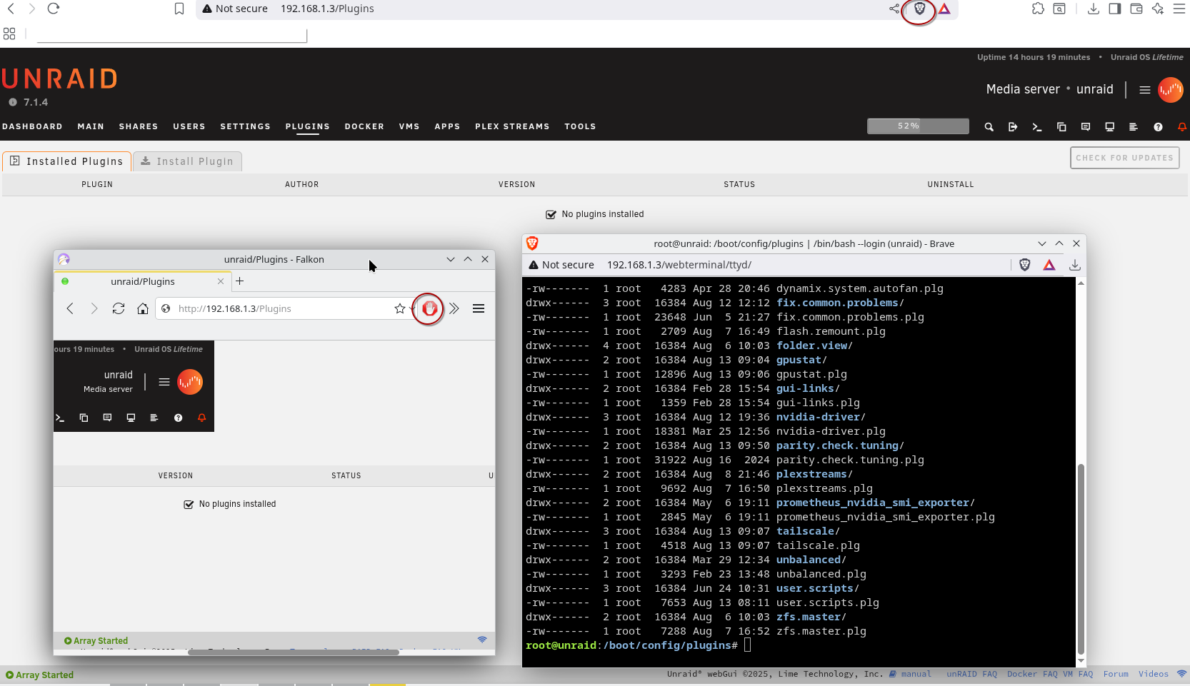

August 15, 20251 yr Author Thanks. I tried this yesterday evening with partial success. Libvirt works again, and I've built two VMs!No change with the plugins - they still show until the array begins to start, then disappear. I also checked the syslogs, and I still have 3 files - syslog, syslog1, and syslog2 - and the dates have changed, so they're definitely fresh, not just leftovers.I think I created the new /boot/config correctly, but possible I made a mistake. I will re-attempt tonight/tomorrow with a freshly created flash drive.I appreciate your help thus far!
August 19, 20251 yr Author I'm pressing the pause button for a while. The issue with the plugins page still isn't resolved, but I am still experimenting as I have time.

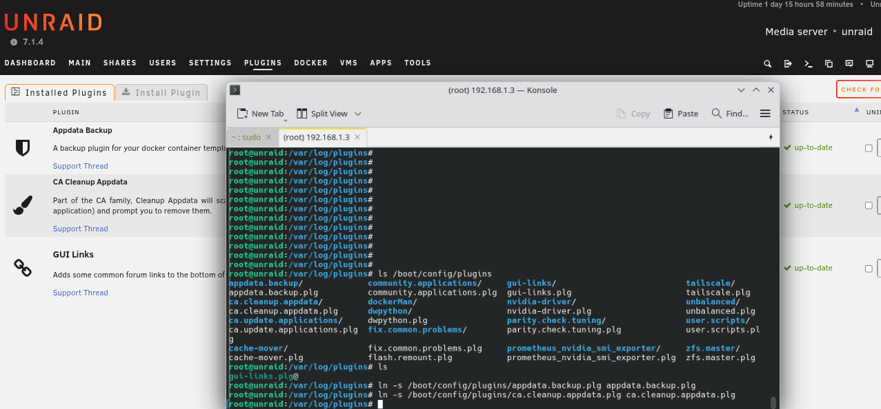

August 23, 2025Aug 23 Author Solution RESOLVED!!! đAfter a LOT of effort and research, I finally learned that /var/log/pluginshas to exist, andhas to contain symlinks to each plugin located in /boot/config/pluginsI had to create the symlinks manually (see screenshot), but after doing that, I'm good to go.Thank you, JorgeB, for your assistance! Edited August 23, 2025Aug 23 by molasses2
