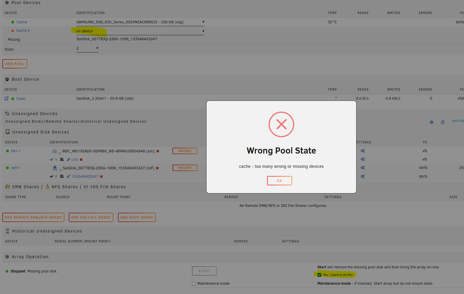

I have now tried to remove the second drive by stopping the array, removing the drive however i cannot change the drive pool number from 2 to 1 the option is not there. I did read that you just need to start the array selecting the "Yes" tick box but this just gives an error message stating that there is a wrong pool state
If anyone could please help me with some steps on how to get the array back to a working state with or without the redundancy drive it would be gretly appreciated. I noted that adding a diagnostics file can be helpful so I have attached one.

You cannot remove a device because the pool profile is not raid1, but Btrfs is detecting data corruption. I suggest running Memtest first, then try to copy what you can from the pool and reformat.
