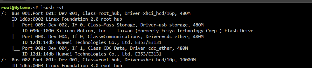

Post the output from lsusb -vt
all of the sudden just worked! so i marked as a solution!!
thank you
