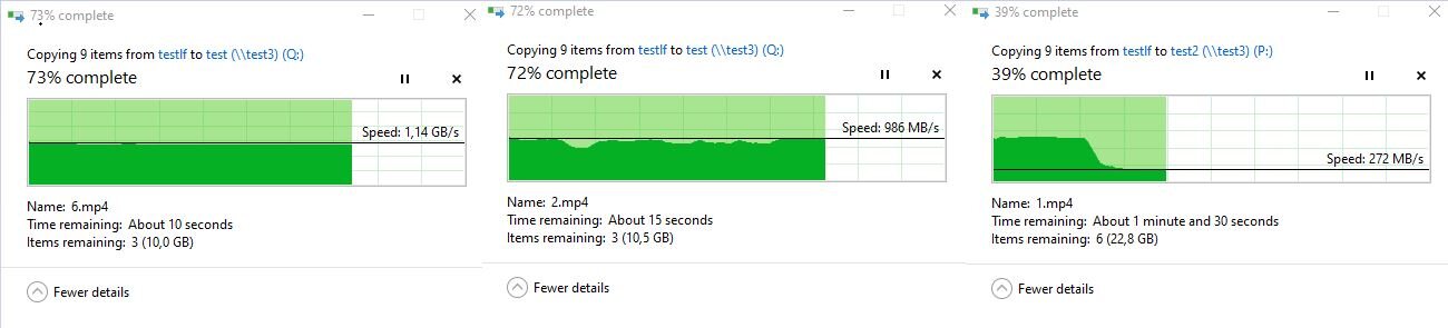

That Windows Explorer graph suggests a network issue, despite the good iperf results.
1st is a good transfer for 10GbE, 2nd shows consistently slower performance, network problem in this case created on purpose, 3rd shows initial fast transfer while it's being cached to RAM, and then slowed by the device's actual speed. Yours looks like the 2nd one.
