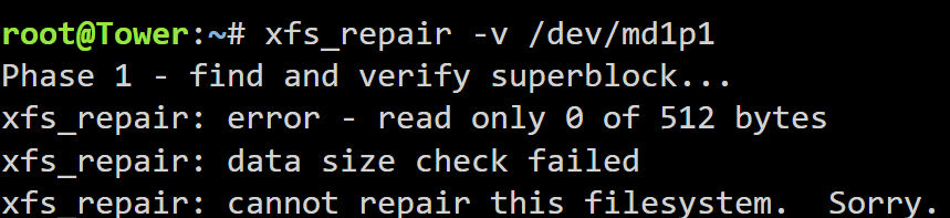

Now I get the error message "Unmountable: wrong or no file system" on one of my drives, when I want to start the array.

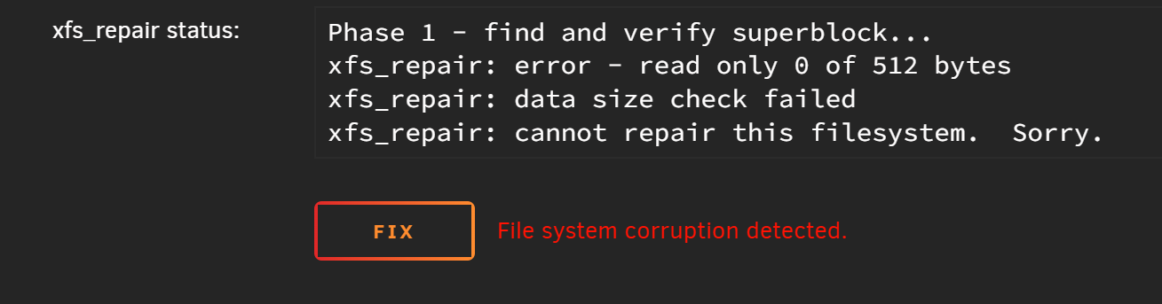

When I try a xfs_repair i get the following error.
Can somebody help me with this? Kinda new to unraid.
Drive is about 10 Months old and worked perfect before the update.
Thanks in advance!

Not seen that error before!
You are likely to get more informed feedback if you attach your system's diagnostics zip file to your next post in this thread.
It is always a good idea to do this to allow us to see the current state of your system and so we can see logs.
Aug 15 06:26:28 Tower kernel: mount: attempt to access beyond end of device
Aug 15 06:26:28 Tower kernel: md1p1: rw=4096, sector=15628053063, nr_sectors = 1 limit=15628052376
Looks like the disk wasn't using the actual partition before, Unraid 7.1.x will use it now. Downgrade back to the previous release (Tools - Downgrade OS), the disk should mount again. Post new diags wi tht earray started so that we can see which partition layout it's using.

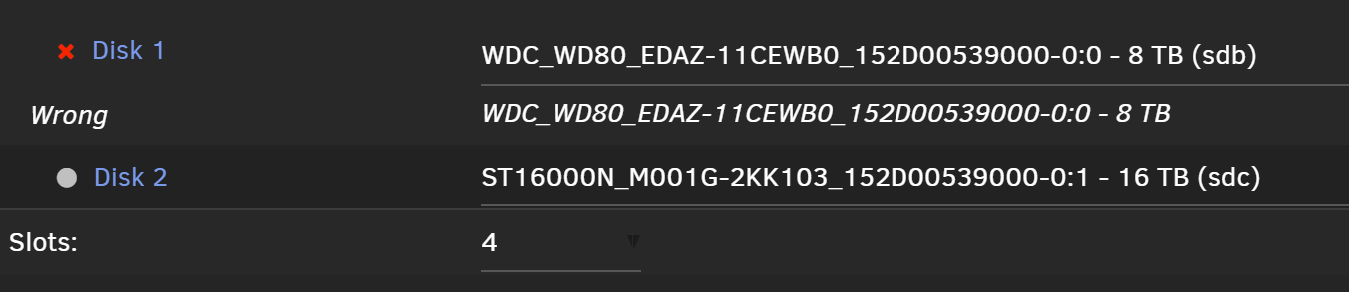

Now its says wrong drive
That suggests you did a new config after updating before; you will need to do another one
