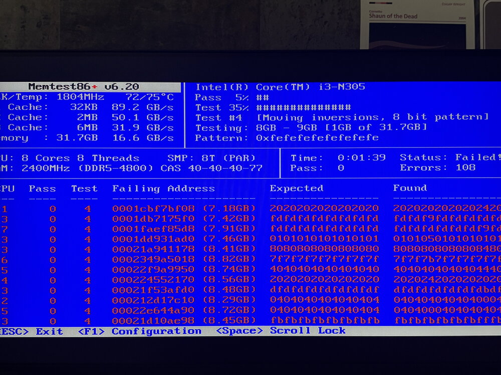

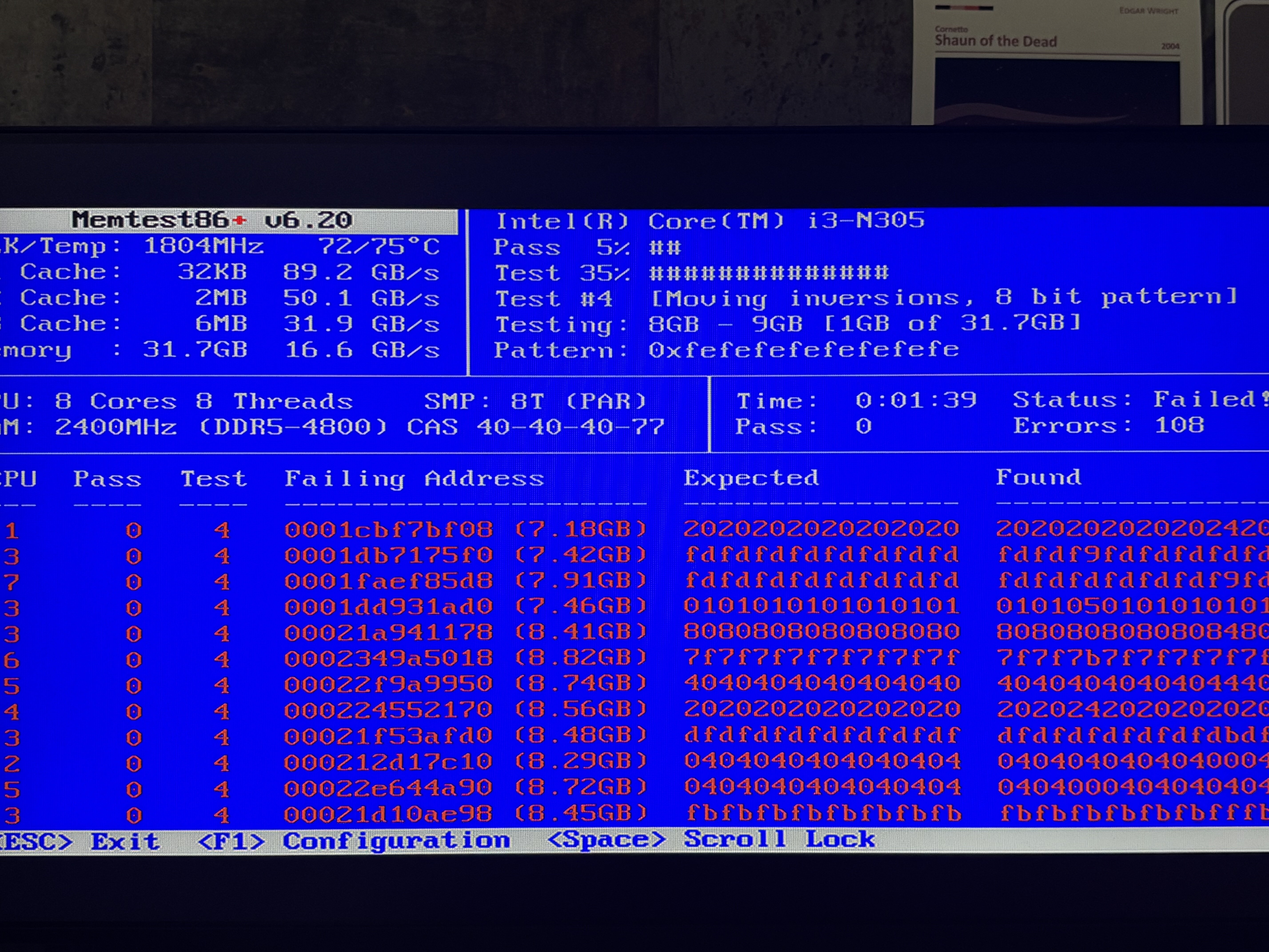

Solved by behem0thuk
sorry to waste peoples time.
Turns out a good old Memtest caught the issue straight away didn't even get passed 3% before it failed.
