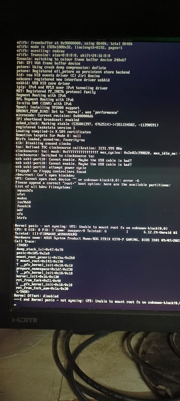

Please check the screen shot, server is not booting. Last thing I did on machine is changed CMOS battery on motherboard. Could this be an issue or it is something different. Any means I can check error on unraid USB? I am using this machine as normal windows PC with additional boot SSD and machine is working fine with windows. Just to mention, unraid HDDs are disabled in windows environment.

Try recreating the flash drive, first backup the current one, then recreate it using the USB tool, confirm the flash drive boots with the stock install, and if yes, restore only the /config folder from the backup overwriting any existing files.

Sincere apology for not posting in forum and updating troubleshooting for so long. Troubleshooting in windows revealed that SATA expansion card was faulty. Additionally power cable for one data disk was also faulty. No action taken on USB. Now tower is healthy. Did Parity check, no errors.
