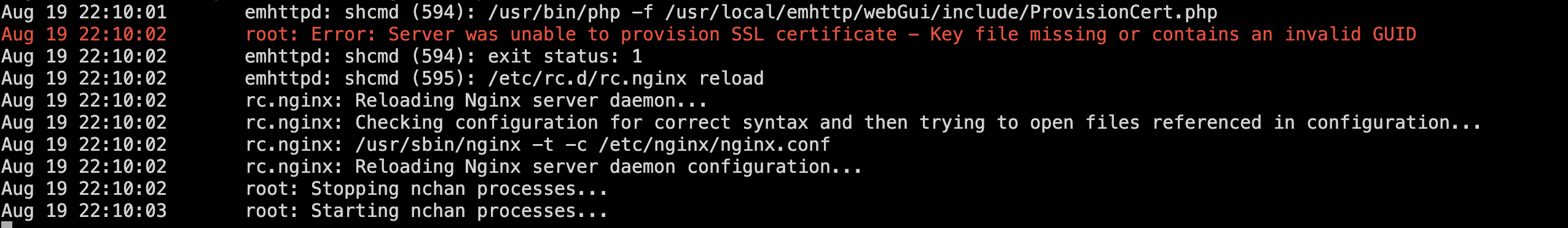

I've installed a new Unraid server and I'm having trouble installing an SSL certificate through Unraid. I've already tried changing the port and forwarding the router's ports, but I'm getting the following error message:
Does anyone have a suggestion or a solution for this?

Yours is throwing an error that the file is missing the key ... maybe at least part of that would be useful for you?
