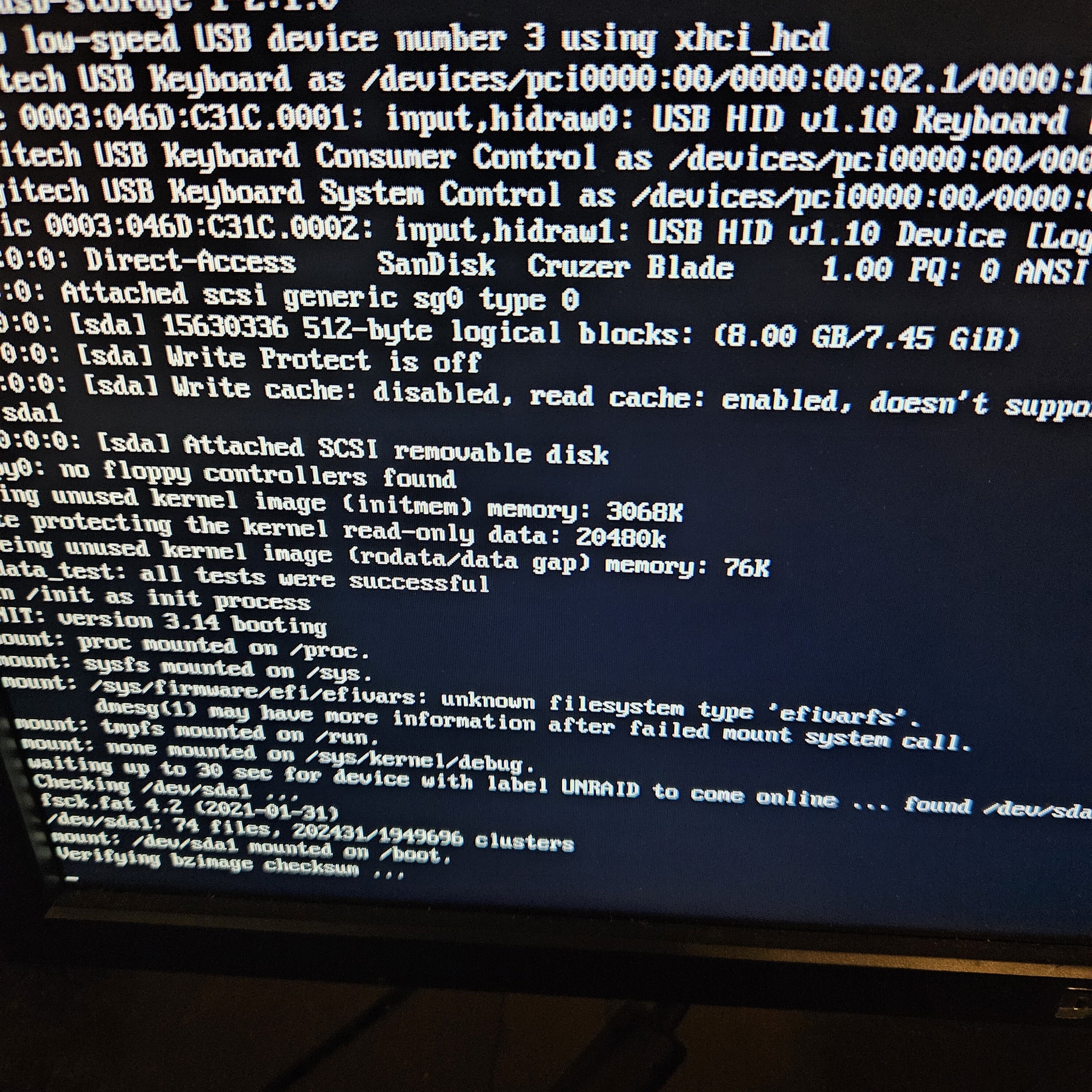

So the other day I rebooted my UDMP and my Unraid server did not come back online. I rebooted it and now it will not boot. I have tried brand new flash drives using the creator tool, fresh flash of a new Unraid file, all the USB ports, and I used the flash drive in a laptop and got it to boot Unraid. I do see a message about an unknown filesyste type 'efivarfs' that only seems to appear when I try to boot up on the server. I did not see this message on the laptop that was able to boot Unraid. I did a memtest and it passed. I do not know where to go from here.

Sorry, only looked at the photo, since it's a common issue.
If a new flash drive with a stock install, before restoring any backups, doesn't boot, there's likely some hardware issue.
This is harmless; it shows for everyone doing a UEFI boot, it no longer shows with 7.2.0-beta.1

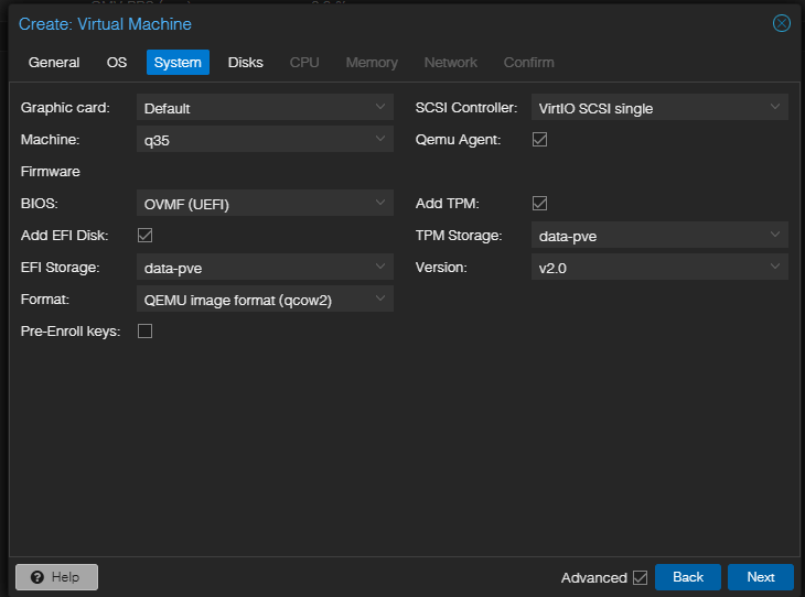

check out my unraid porxmox guide...
If i'm understanding you correctly your tying to get proxmox to VM boot unraid.
Edited by bmartino1
in proxmox when making the VM you want to make sure you don't enroll the secure boot keys. the efi var error is due to secure boot.
Edited by bmartino1
Fourm Picutre Uplad being weird
I am not trying to open Unraid in a VM using Proxmox. My Unraid server will not boot Unraid. I only used a Proxmox install USB to see if I could get to the installtion page.
issues still the same efi vars is a courpted USB on physical Machines where secure boot doent' acept the efi data.
Turn off secure boot in bios.
