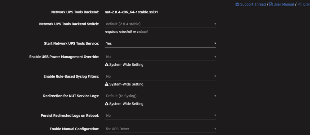

For future folks there is just one setting to change in the UI:
Enable Manual Configuration -> For UPS Driver
Then copy/paste Berzdorfers configuration to the config file at the bottom
Then start the NUT service

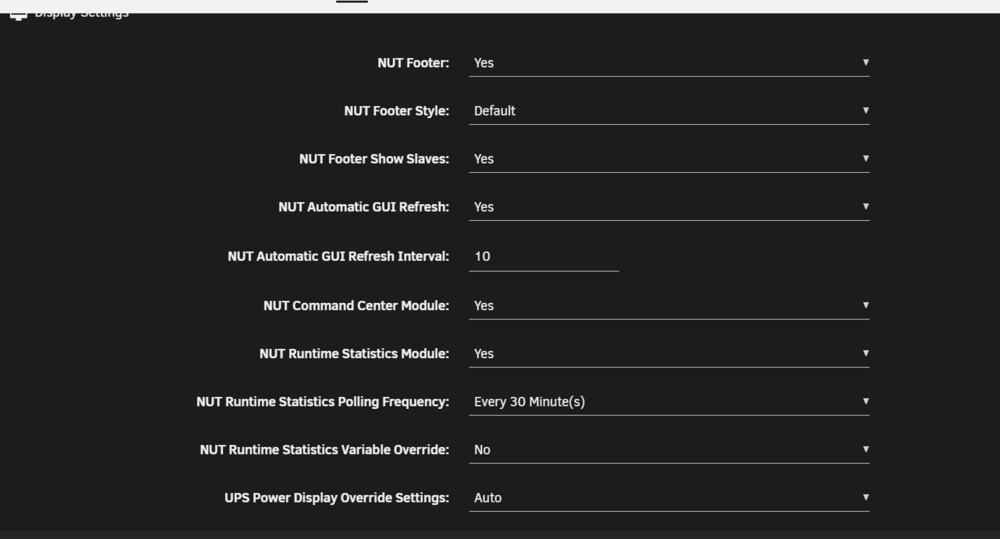

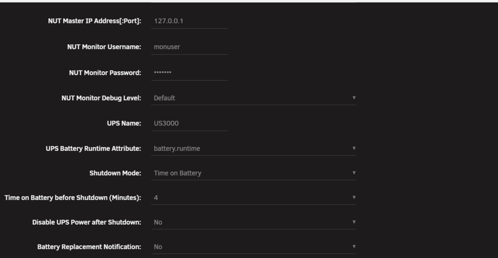

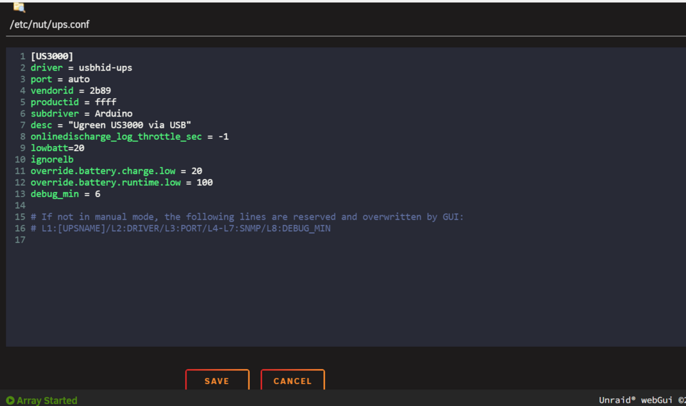

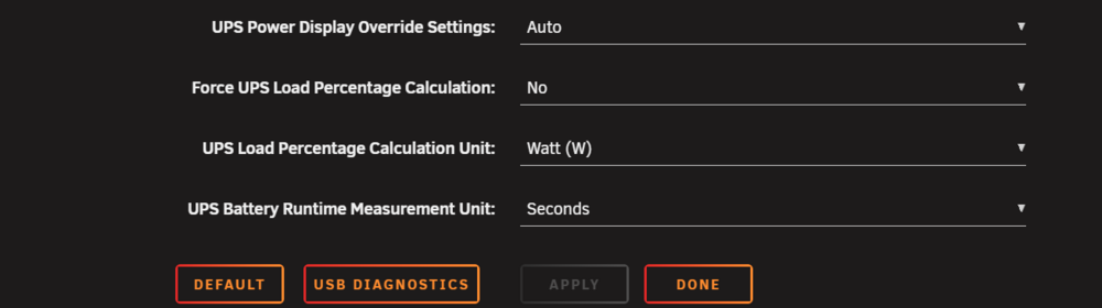

I found the solution to this!
Unbelievable that I missed this, but maybe I'm not the only one. In the UI configuration there is also a UPS Name field, I somehow thought this is overriden with the config below but it's not. The names need to match, then it works fine.
Thanks all, thought I'd end the post here with everything as a screenshot so any user can see on what settings they need to get a ugreen UPS working with NUT in unraid.
Got it working good thanks to the above posts!
Here's screenshots for any future unraid, ugreen ups :)
Config:
Display Settings:
The rest of the settings:

On 6/30/2026 at 4:28 AM, Trent Curtis said:
I just setup the US3000 on a DXP4800 Plus, has anyone found a solution to the excessive logging other than changing it to log to file and not syslog?
I removed
debug_min = 6
from the config and that seems to have helped?
so my config just reads
[US3000]
driver = usbhid-ups
port = auto
vendorid = 2b89
productid = ffff
subdriver = Arduino
desc = "Ugreen US3000 via USB"
onlinedischarge_log_throttle_sec = -1
lowbatt=20
ignorelb
override.battery.charge.low = 20
override.battery.runtime.low = 100

Cause (in my case) I had NUT debug logging switched on, at level 6, in two places:
  1. debug_min = 6 in ups.conf.
  2. The plugin's upsmon debug level setting (DEBLEVELMON="6"), which writes DEBUG_MIN 6 into upsmon.conf.

DEBLEVELMON="default" in /boot/config/plugins/nut-dw/nut-dw.cfg (or the "upsmon debug level" setting in the plugin GUI)
rc.nut rewrites line 8 of upsmon.conf from this on every start. If you edit upsmon.conf directly, it is overwritten.
driver debug off
Remove debug_min = ... from ups.conf (NUT Editor, or edit the file)
In "For UPS Driver" manual mode the GUI's driver debug setting is ignored, so the line lives in your own ups.conf.
