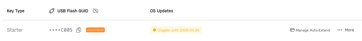

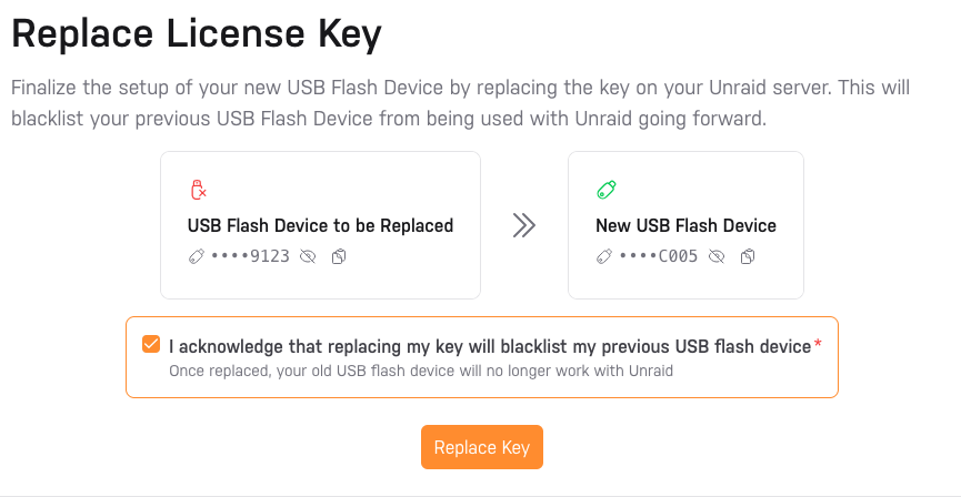

August 23, 2025Aug 23 I had problems with the Apps page hanging. Suggestions on this forum lead me to create a new USB, copy my old /config/ directory to it and perform the "Replace Key" function.It failed and every attempt to do it again keeps failing. Now what do I do? I have a useless NAS at this point.Update: Looking at the Replace messages is shows:Looking at my account at UNRAID it shows:So the problem seems to be that the GUID is updated online already so the replacement can't happen "again".Can anyone help me get these in sync?Gary Edited August 23, 2025Aug 23 by galgier Update
August 23, 2025Aug 23 Author I did open a case with support but I fixed it myself before I got a response from them.Poking around in the license section of unraid's web site I found I could download a file: Starter.keyI looked on my NAS in /boot/config and it was a zero length file. I replaced it with the contents of the download and rebooted. It cam up properly licensed.Now to get the Apps page to work again. The USB replacement was attempt to fix that problem.Thanks
