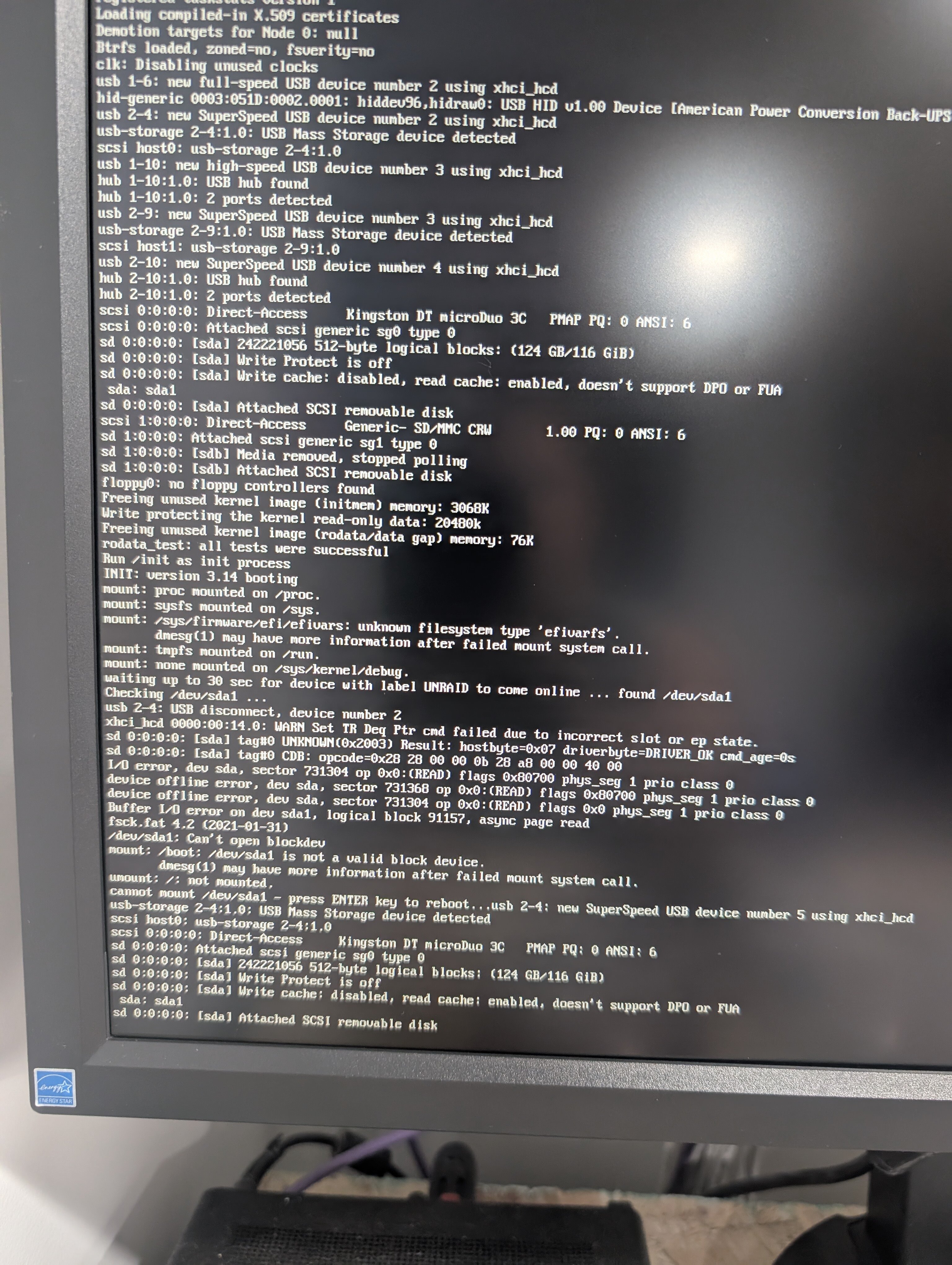

I currently have a small 2gb flash drive that I would like to upgrade. The smallest I could find is a 128gb USB-A/C flash (it has both port) from Kingston. I backup my unraid flash using the ui, download the usb creator 1.0.1, selected the flash and flash it on my usb. I just tried booting it and I get an error saying /dev/sda1 doesn't exist during the boot sequence.
I tried doing it the manual way and same thing.
See if it boots with a stock install, if yes, then restore only the config folder from the backup.
nop same error with stock install
If it doesn't boot with the stock install try a different flash drive, or that flash drive in another PC to confirm where the problem is.
Tested on my computer and it boot
Server is a precision 5820
Edited by Nodiaque
ok so I bought another key and this one work. Now I'm stuck waiting for the new key in my email.... IS that suppose to be long?
