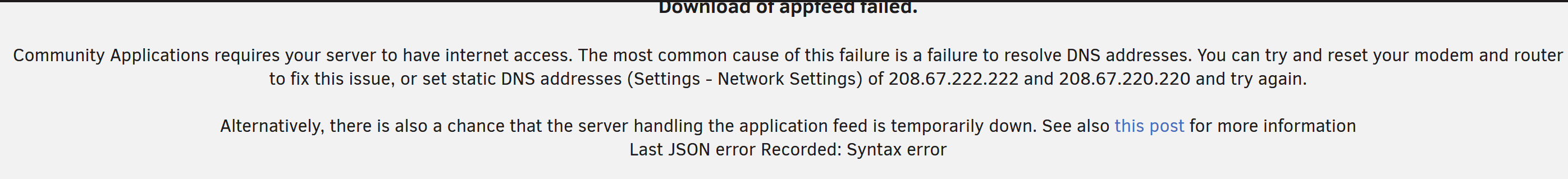

After I upgraded my Unraid server from 6.12.14 to 7.1.4, I can no longer access community apps and got the following error messages. After downgrading to 6.12.14, the problem was gone.
I searched the forums and tried suggestions there, but had no luck.
One thing I found that this issue seems to be related to the docker container "nginxproxymanager". In 7.1.4, after stopping ""nginxproxymanager"", the problem was gone.
Any suggestion will be much appreciated.
In that case recommend looking for the support thread for that container and asking there; it could be a bad config:
Thank you. I will try the support thread of NPM.
