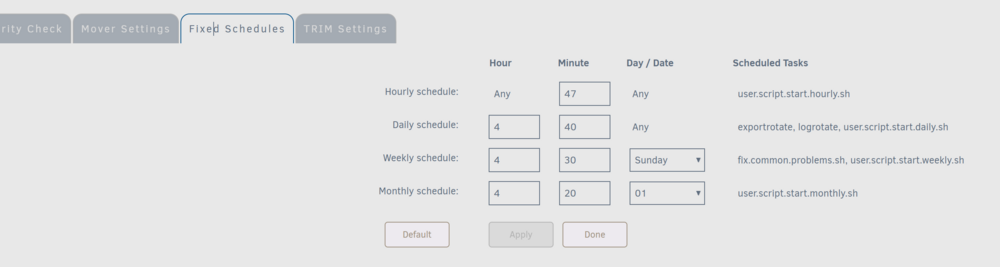

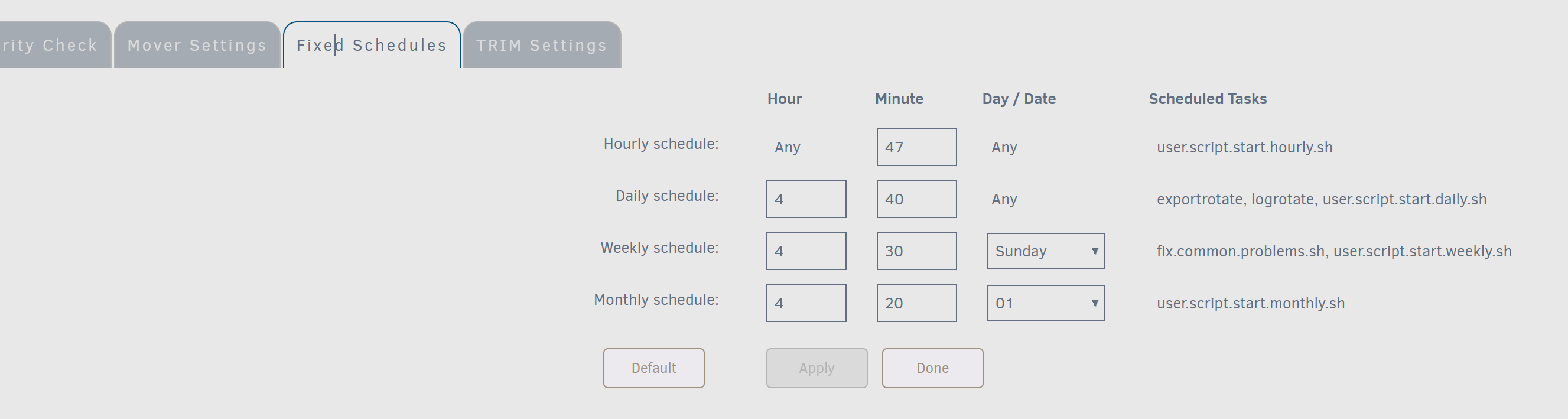

I can even see th exact moment in the power readout of the smart plug, and I was in bed at that time :)
Yeah I know these evil creepy hamsters very well...
BTW: what you see at night maybe the general cron job of UNRAID which fires up at 04:40. It is normal that all drives spin up at that time.
This may include disk checks and so on... keep that in mind...
Edited by MAM59
I finally found the culprit.
I was using a home assistant integration to connect to the unraid api and that was for whatever reason keeping the disks constantly spun up.
If HA is trying to get smart status or temperature of the drives, then that does cause the drives to spin up. Maybe adjust HA and the integration to not query spun down drives
