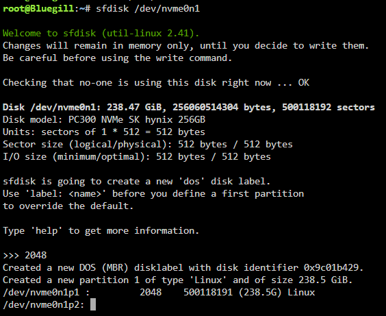

September 2, 2025Sep 2 Community Expert There's no partition; you can try and see if the old fs signature is still there, worth a try.Type sfdisk /dev/nvme0n1, then type 2048 and enter and post the output; don't do anything else for now.

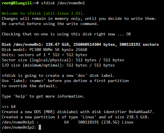

September 3, 2025Sep 3 Community Expert No ZFS signature detected. You can try the other possible sector Unraid can use; hit CTRL + C to abort, then type sfdisk /dev/nvme0n1, but now type 64 and enter and post the output.
September 3, 2025Sep 3 Community Expert I'm afraid there's no previous signature, suggesting the device was fully trimmed or wipefs was run on the partition before deleting that as well. You will need to recreate the pool, if there was important data there, you could also try a file recovery app, like UFS Explorer; the free trial should show if it can recover anything.
