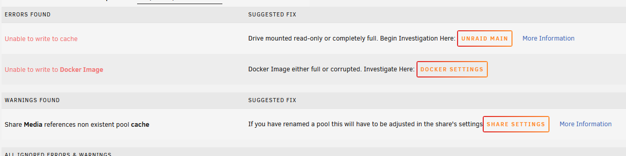

Fix common problems shows my cache as read only or full...it's not full though. Have >500GB free.

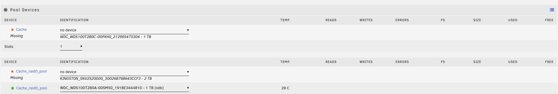

Further to this, when I stop the array now TWO drives are missing, both are NVME I think.
It's weird as they only show as missing when I stop the array. They seem to start fine with unraid and don't display any issues until I stop the array.
