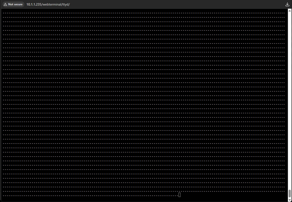

I am currently have been running this command, after stopping my array and putting it in maintenance mode. I ahve been running this command, for the past 8 hours:
xfs_repair -v /dev/sdh (20 TB drive)
It talked about finding a secondary superblock... and all I see this... over and over

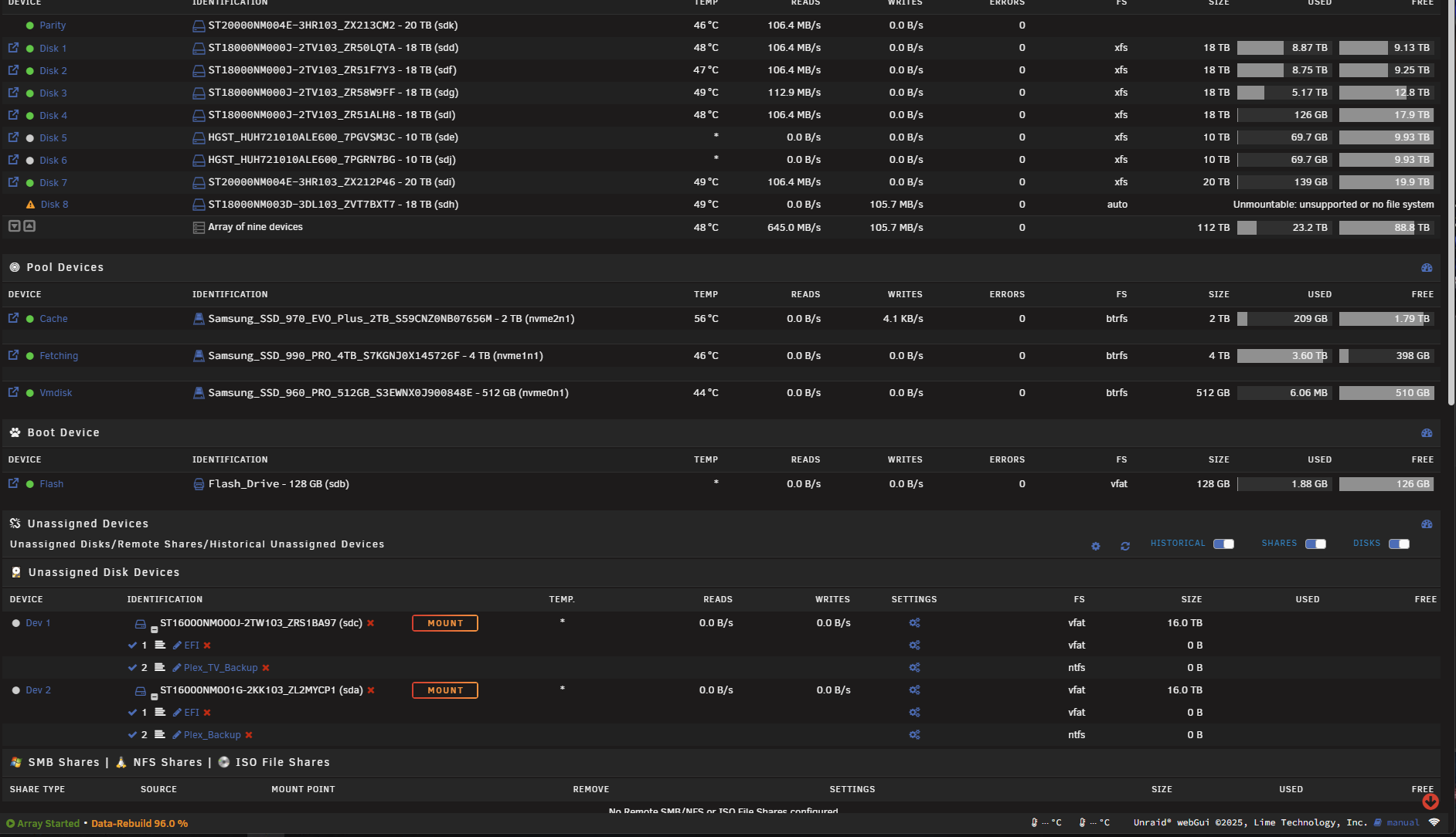

wipefs /dev/md8p1 listed no output with array started
should I have used wipefs /dev/sdh? (Disk 8 is issue and it is 18 TB not 20 sorry)

Unmountable: unsupported or no file system
Here is the diag filesithlord-diagnostics-20250903-0657.zip

xfs_repair /dev/md8p1
Phase 1 - find and verify superblock...
bad primary superblock - bad magic number !!!
attempting to find secondary superblock...
will check when I get back home!
It did not work, so since this is a single disk failure, I think I will just attempt to rebuild the drive after formatting it, @JorgeB is that ok?
I did some digging and went down this path and it seems to be working...

At this point, I decicded to try to rebuild... I think I see what happened... the system crashed ad casued this system to act up...
I have set the disk to no device and then selected this... Start will disable the missing disk and then bring the array on-line. Install a replacement disk as soon as possible. Yes, I want to do this
Reassign Disk 8 and Trigger Rebuild
  1. Stop the array again.
  2. Go back to the Disk 8 dropdown and reassign your drive: ST18000NM003D-3DL103_ZVT7BXT7 (sdh)
  3. Scroll down and click Start.
  4. Unraid should now detect that Disk 8 is “wrong” and offer to rebuild it from parity.
As soon as I set the drive to ST18000NM003D-3DL103_ZVT7BXT7 (sdh) It now says: "All existing data on this device will be OVERWRITTEN when array is Started" When I started it, I see "Started Stop will take the array off-line. Disabled -- Parity operation is running Unmountable disk present: Disk 8 • ST18000NM003D-3DL103_ZVT7BXT7 (sdh) Format will create a file system in all Unmountable disks. Yes, I want to do this Data-Rebuild in progress."
I see this... tail -f /var/log/syslog Sep 3 18:36:57 SITHLORD kernel: docker0: port 4(vethd3c2eb8) entered blocking state Sep 3 18:36:57 SITHLORD kernel: docker0: port 4(vethd3c2eb8) entered forwarding state Sep 3 18:36:57 SITHLORD rc.docker: tautulli: started successfully! Sep 3 18:36:57 SITHLORD rc.docker: tautulli: wait 30 seconds Sep 3 18:36:58 SITHLORD Parity Check Tuning: No restart information present Sep 3 18:36:58 SITHLORD tips.and.tweaks: Tweaks Applied Sep 3 18:36:58 SITHLORD unassigned.devices: Mounting 'Auto Mount' Remote Shares... Sep 3 18:36:58 SITHLORD unassigned.devices: Using Gateway '10.1.1.1' for Remote Shares. Sep 3 18:36:58 SITHLORD unassigned.devices: Waiting 5 secs before mounting Remote Shares... Sep 3 18:37:06 SITHLORD reload_services: execute queued job 18 Sep 3 18:37:27 SITHLORD rc.docker: binhex-jackett: started successfully! Sep 3 18:37:27 SITHLORD rc.docker: binhex-radarr: started successfully! Sep 3 18:37:28 SITHLORD rc.docker: binhex-radarr-cartoons: started successfully! Sep 3 18:37:28 SITHLORD rc.docker: binhex-radarr4k: started successfully! Sep 3 18:37:28 SITHLORD rc.docker: binhex-sonarr: started successfully! Sep 3 18:37:28 SITHLORD rc.docker: SonnarAnime: started successfully! Sep 3 18:37:28 SITHLORD rc.docker: binhex-lidarr: started successfully! Sep 3 18:37:28 SITHLORD rc.docker: Containers started. Sep 3 18:37:28 SITHLORD rc.docker: firefox: started successfully!
I am seeing the data being rebuilt. If this fails then I know what to do next... again thank you for you help @JorgeB I really appreciate it
So far we are looking good:
Is the emulated disk mounting?
Sorry @JorgeB for the late reply.... I was sick yesterday and the drive is still rebuilding... it is at 96% done. I did buy a new 20 TB drive in the event this one fails

@JorgeB I believe we are good now, thanks again!
ipefs /dev/md8p1
DEVICE OFFSET TYPE UUID LABEL
md8p1 0x0 xfs 5c05104a-0a7d-4477-b56a-293fc29435df
Disk8 was still not mounting in the screenshot. Is it mounting now?
Yes it is mounted!
Great, that suggests something wiped the fs from the actual disk, or there was some kind of firmware issue, but it was done directly on the device, and parity was not updated.
