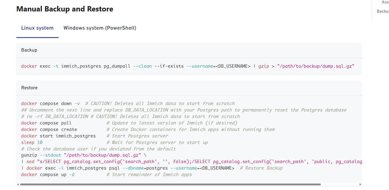

Somehow, messing around with my Docker settings, I managed to mess up my Immich installation - Immich opens, but it had me set a new admin account, etc. All of my media still exists locally and on my backup drives, as does the automatic backup file from Immich. I would like to run the backup script from Immich, as seen below and in their page about backups:
docker compose down -v # CAUTION! Deletes all Immich data to start from scratch
## Uncomment the next line and replace DB_DATA_LOCATION with your Postgres path to permanently reset the Postgres database
# rm -rf DB_DATA_LOCATION # CAUTION! Deletes all Immich data to start from scratch
docker compose pull # Update to latest version of Immich (if desired)
docker compose create # Create Docker containers for Immich apps without running them
docker start immich_postgres # Start Postgres server
sleep 10 # Wait for Postgres server to start up
# Check the database user if you deviated from the default
gunzip --stdout "/path/to/backup/dump.sql.gz" \
| sed "s/SELECT pg_catalog.set_config('search_path', '', false);/SELECT pg_catalog.set_config('search_path', 'public, pg_catalog', true);/g" \
| docker exec -i immich_postgres psql --dbname=postgres --username=<DB_USERNAME> # Restore Backup
docker compose up -d # Start remainder of Immich apps

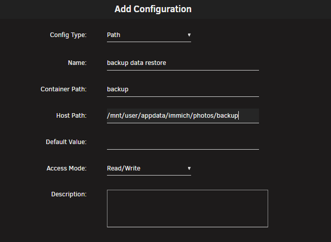

First I recommend adding a data path to the docker. I will use unraid CA examples atm...
so in the web UI. click the dokcer and edit the docker scrool to the very bottom and
add a path
link /backup to the path of your immich folder that has the Postgres restore file.
*This is needed later to use the docker commands and to bring files into the secure container docker environment.
This will make a /backup folder that points to the immich backup that holds the Postgres data we want to restore.

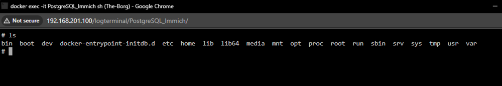

you can click on the docker and go to console.
This should open a terminal window as if you are at a ssh connection on the machine that is the docker.
here, you need to have a path to the restore file added to the docker.
example ls to see folders (*Note this Doesn't have the backup path made above... just example you should see a backup or what ever you called the container path...)

So now lets review the immich documentation... Immich from command line since Postgres is a docker we use docker tools and on unraid host(we open the web terminal) we would execute something like this:
docker exec -t immich_postgres pg_dumpall --clean --if-exists --username=<DB_USERNAME> | gzip > "/path/to/backup/dump.sql.gz"

so from the documentation ocne you have the sql file we can then use terminal commands to restore
this restores the sql file to a database named postgres.
as again many ways to accomplish it..
