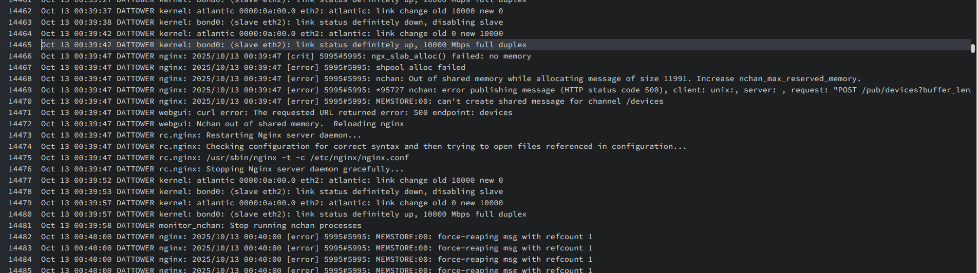

i did notice this in the logs however. 4 times same entry in less than 10minutes.
webGui/nchan/parity_list timed out after 30 seconds. Exiting.
navigating around the GUI i was able to produce some more.
Sep 7 21:11:43 DATTOWER publish: webGui/nchan/device_list timed out after 30 seconds. Exiting.
Sep 7 21:11:48 DATTOWER publish: webGui/nchan/parity_list timed out after 30 seconds. Exiting.
Sep 7 21:22:27 DATTOWER flash_backup: adding task: /usr/local/emhttp/plugins/dynamix.my.servers/scripts/UpdateFlashBackup update
Sep 7 21:22:39 DATTOWER publish: webGui/nchan/update_2 timed out after 30 seconds. Exiting.
Sep 7 21:22:40 DATTOWER publish: webGui/nchan/update_1 timed out after 30 seconds. Exiting.
Sep 7 21:22:41 DATTOWER publish: webGui/nchan/vm_dashusage timed out after 30 seconds. Exiting.
Sep 7 21:23:13 DATTOWER publish: webGui/nchan/wg_poller timed out after 30 seconds. Exiting.
Sep 7 21:23:13 DATTOWER publish: webGui/nchan/update_3 timed out after 30 seconds. Exiting.
Sep 7 21:23:17 DATTOWER publish: webGui/nchan/ups_status timed out after 30 seconds. Exiting.

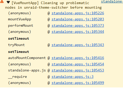

an issue that is persistent is for example. the gui Unraid Icon (top right) the Connect Menu. sometimes it hides after click (refresh to bring back - dissapear after click again). But every time (when menu isn't disappearing as mentioned before) I click the submenu for ConnectMenu>Settings or ConnectMenu>GoToConnect, nothing happens at all. Happening on Stable version for me. the other options are working ok (Check for update, My Account, and sign out).
Just to note: tried on more than one end point and browser vendor. Adding some notes below for browser investigation
https://10.10.10.10/plugins/dynamix.my.servers/unraid-components/nuxt/standalone-apps.js

Edited by DejMacro
missed mention of troubleshooting of browser behaviour to confirm
Plugin update just came through, Version 2025.09.08.1804 fixed GUI issue. even the display issue from API keys in the Connect settings page.
That was short lived. Behaviour is back to Connect icon dissapear and API section missing from Connect settings page.
Edited by DejMacro

ok had another crash - i had quite a few things in motion this time (so feeling a little more negative this time). everything just freezes up (network adapters offline - all activity ceases) . I tried adjusting the syslog to store locally. but looks as though also issue with this. Does it appear that it's unable to write to this location.?
I have tried more than one share. and doesn't appear to be generating any files. What is the easiest way i can catch this little terror in its tracks?!??
Oct 11 10:21:52 DATTOWER webgui: Successful login user root from 192.168.1.71
Oct 11 10:26:36 DATTOWER ool www[157695]: /usr/local/emhttp/plugins/dynamix/scripts/rsyslog_config
Oct 11 10:26:36 DATTOWER rc.rsyslogd: Restarting Syslog server daemon...

Oct 11 10:33:14 DATTOWER nginx: 2025/10/11 10:33:14 [error] 5995#5995: *2147 open() "/usr/local/emhttp/webGui/javascript/ace/mode-log.js" failed (2: No such file or directory) while sending to client, client: 192.168.1.71, server: , request: "GET /webGui/javascript/ace/mode-log.js HTTP/2.0", host: "192.168.1.152", referrer: "https://192.168.1.152/Shares/Browse?dir=/mnt/user/Downloads"

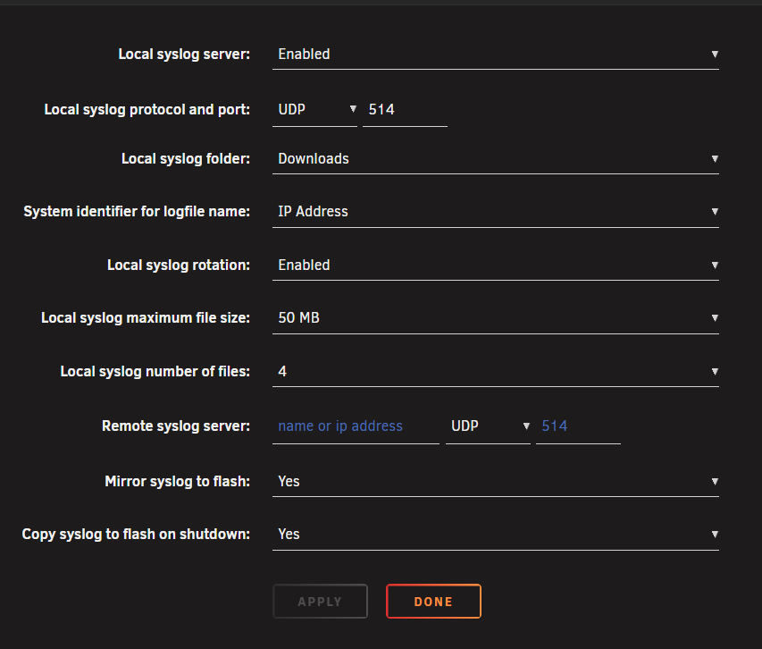

If this isn't from the persistent syslog, post a screenshot from the syslog server settings page.
You need to enter the local server IP in the remote server field; see the instructions.

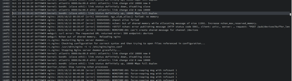

The last line was repeated till the second image - 20,000 lines at the same time stamp. however server crashed at 7am many hours later. nothing really posted in logs immediately prior to system offline. was sitting powered up and unresponsive.
image.png line
removed due to length
Edited by DejMacro
That syslog appears to be after a reboot, it only covers 3 minutes of uptime, and next time, please attach it to the forum; don't copy/paste its contents.
my apologies.
Have attached latest 2 from usb, after repair usb and make bootable i am back up running for the moment.

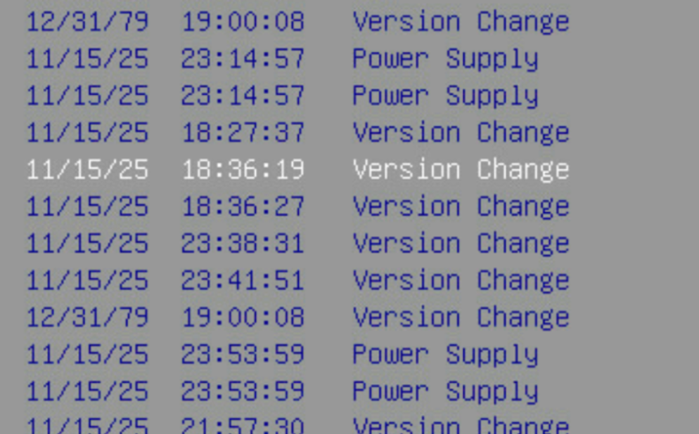

I did notice some power events in BMC/IPMI from recent time before crash.
The logs I have posted don't give me confidence of an OS side issue causing freeze.
going to consider this a power issue for the time being.

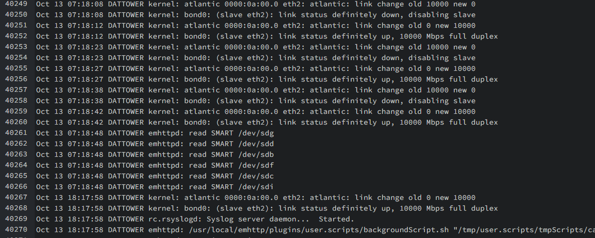

I don't like all the kernel errors in unraid logs. not sure i can do much with them from my experience so far
many thanks
