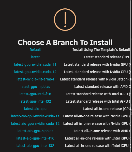

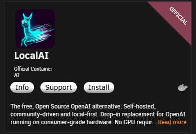

First step is configuring the basic setup. I only have about 16 GB available on my Docker vDisk. Should I be mapping out an external share location for the LLM images themselves, or are they going to run directly from the vDisk storage? If they copy directly to the vDisk, I'd have to increase the size first. I'm assuming that The docker image runs on the vDisk, it accesses the LLM from a separate storage location, and loads the LLM into memory on startup?
I think I'm going to use LocalAI (https://localai.io/), but the description implies that the LLM would be directly in the vDisk? Any insight on that?
