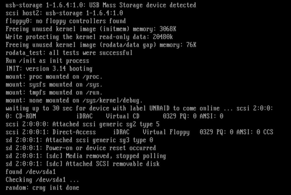

Getting a hang on Unraid when booting after an upgrade that looks like this. The device was updating to 7.1.4 and needed a reboot in order to complete the upgrade.
### First things tried
- Booting into safe mode / GUI Mode
- Rebooting / Powering off-on
- Reviewing logs - there seems to be no errors in the logs at all.
- Review of Forum and Google to see if I can find someone with a similar issue specifically mentioning "random: crng init done hang unraid" - None found that matched my situation (No GPU etc.)
- Reviewed boot issues on Unraid Documentation
Any help is appreciated here

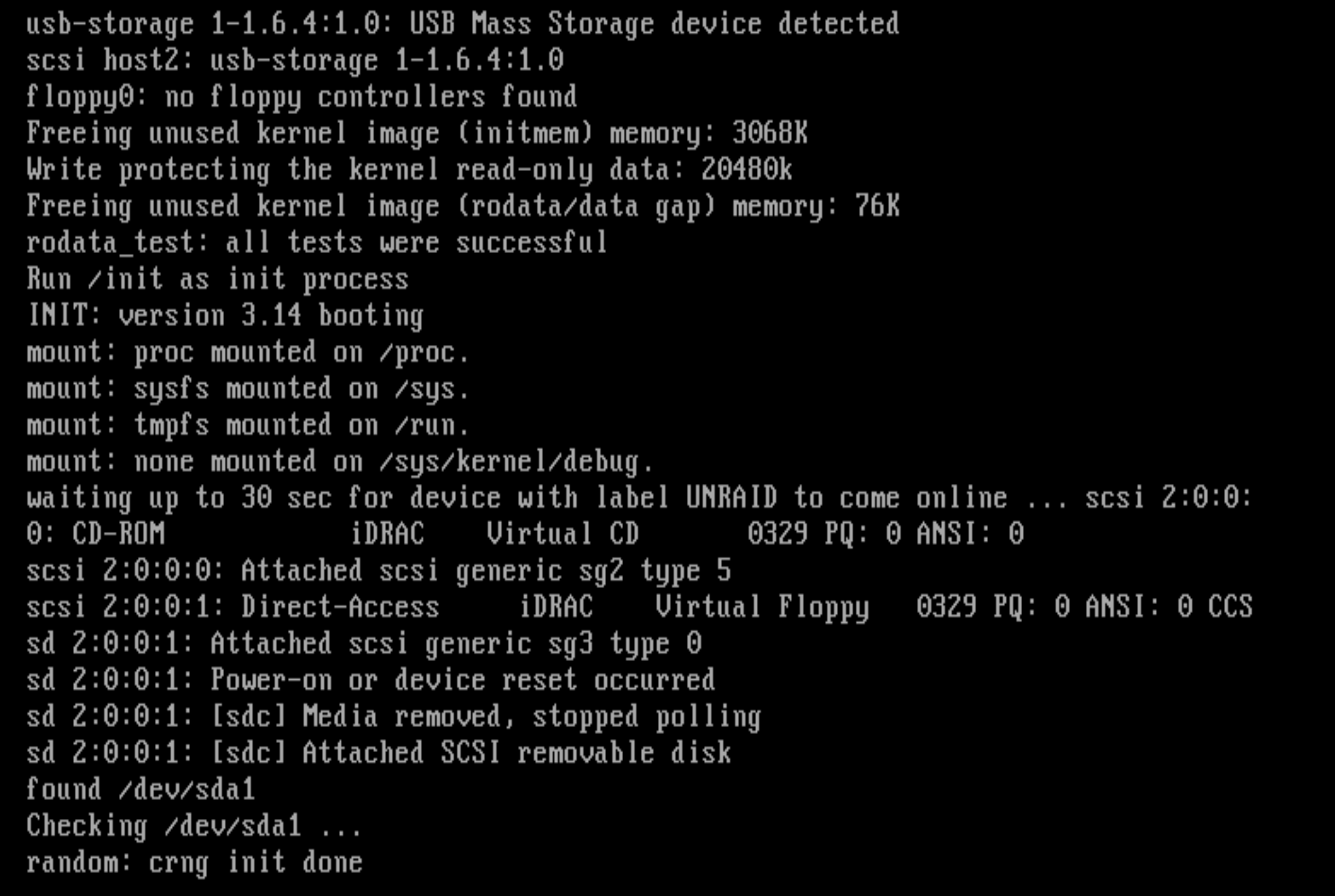

Try booting from a different flash drive using a stock install, no key needed, to see if it's a config problem.
