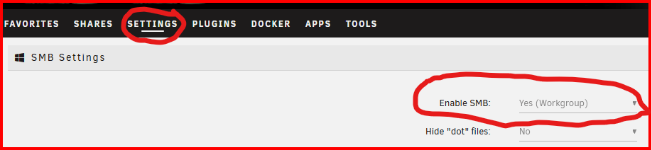

I missed the significance of this statement. Let's have a look at the Unraid side of the equation. (Most of the questions that we see about no connection via SMB are because the security restrictions that MS has on Windows clients!) First, look at SETTINGS >>>> SMB and see that SMB is enabled:

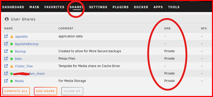

Next check to see that you are 'exporting' the share via SMB. See this screen shot before:
To enable a share, click on the Share NAME in the left column an look at the settings. If you set the security to anything but 'Public' (Very bad choice-- IMO), you have to set the access right for every user that you want to have access to the share.

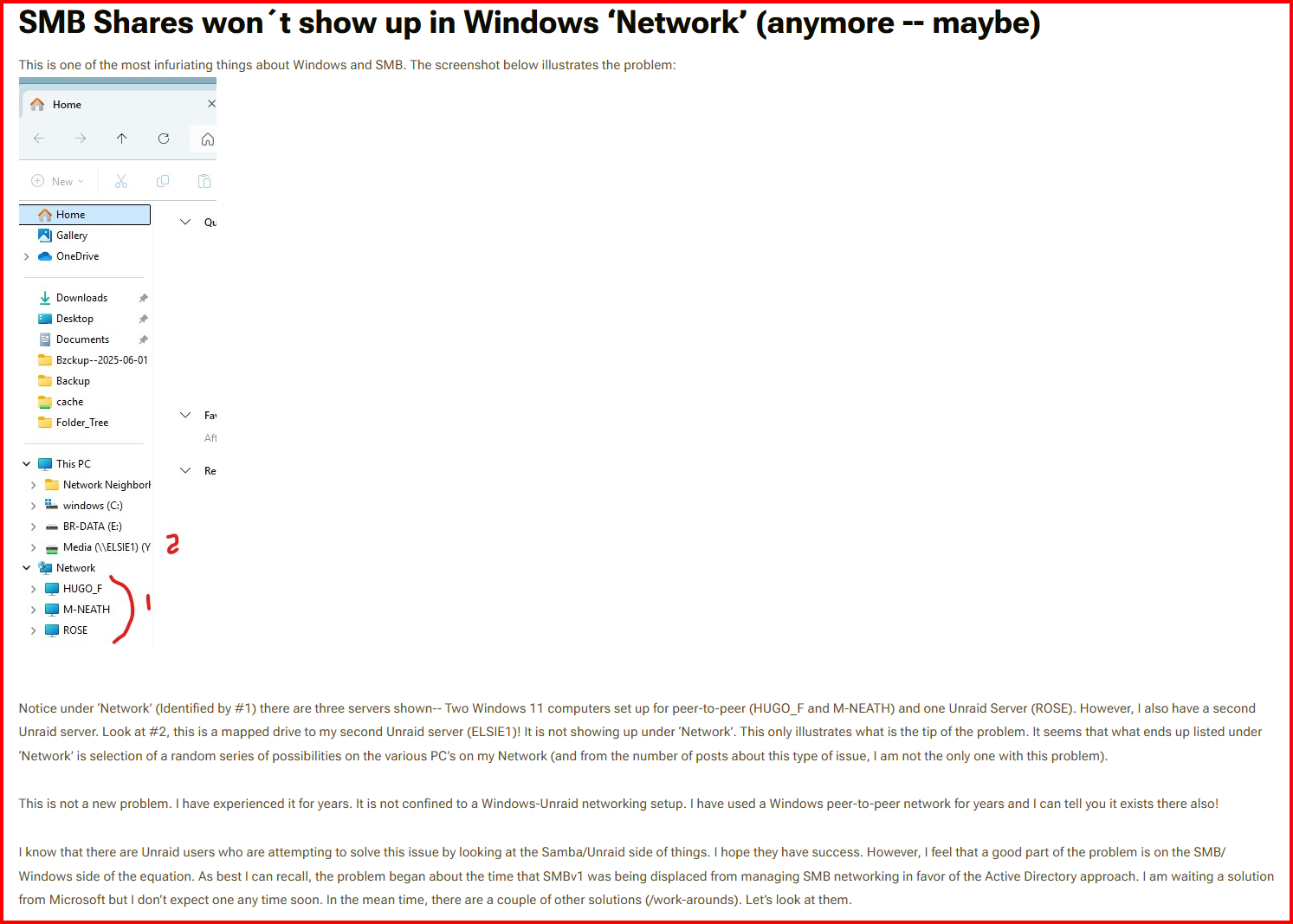

This was a bit confusing to me. If you are having problem seeing your Unraid server under the 'Network section, you are not alone! See here to address that issue:
https://forums.unraid.net/topic/191221-some-musings-on-smb-and-samba-and-unraid-and-windows/#findComment-1561585

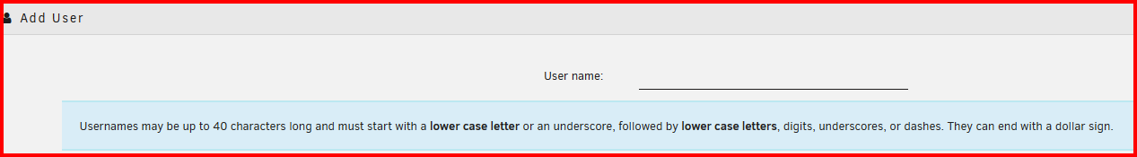

Also please note that Unraid Share user names have restrictions on the characters in the user name.

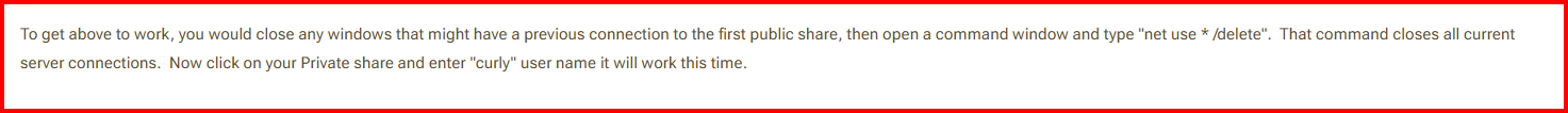

Two ways that I am aware of:
1-- reboot the Windows client.
2-- This:

If this is your problem, I can feel for you. Look at this section in this thread:
I think that explains it all at this point in time. What is aggravating is that it sometimes works and sometimes it partially works... I don't expect an solution anytime soon! (This morning after booting this PC that I am composing this message on, either of my two 24-7 Unraid server are showing up! I have gotten to the point that I never even look even look to see what is there. I just use the 'pinned to quick access' shortcuts.)
I had a light bulb minute when I was thinking about the .local issue. I suspect that is actually a router thing. The .local tells the router that the resource is on the LAN and not the WAN. That would explain why it shows up so randomly on the forum. (I just check and my router does correctly resolve the \\*server_name*.local correctly. But it does not normally need it.)
