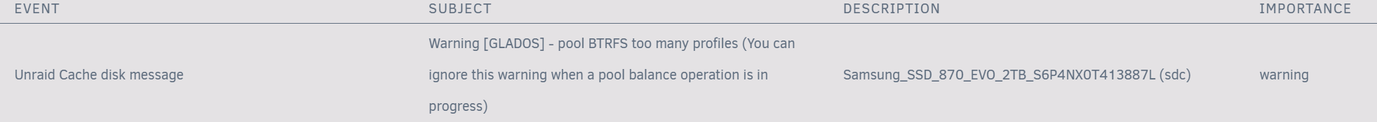

I also got this error do I need to re-balance? It does say there is a 'BTRFS operation is running' so I should leave it to re-setup itself?

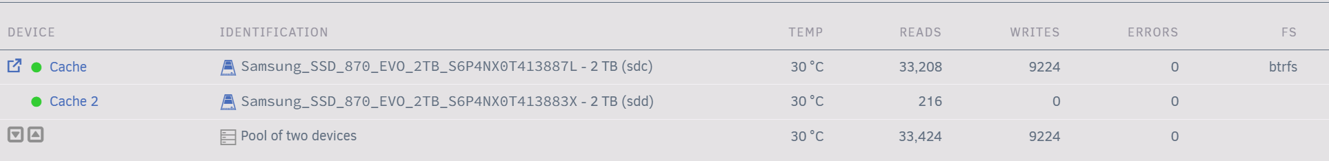

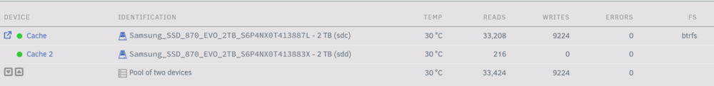

Seems like both are online does this look right? glados-diagnostics-20250921-1516.zip
Just interesting that there isnt any write actions on the other drive just yet
The device is currently online, but it's not part of the pool, and there are still what look like bad SATA cables errors logged:

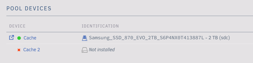

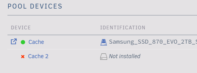

@JorgeB I finally got around to replacing the cable due to just having time etc,
Server is showing the drive and also showing a missing drive on the cache,
I don't seem to see similar errors but I could just be looking at the wrong spot on the logs, can you confirm the logs look correct and whats next to clear this error and re-make the cache?
glados-diagnostics-20251102-1717.zip
