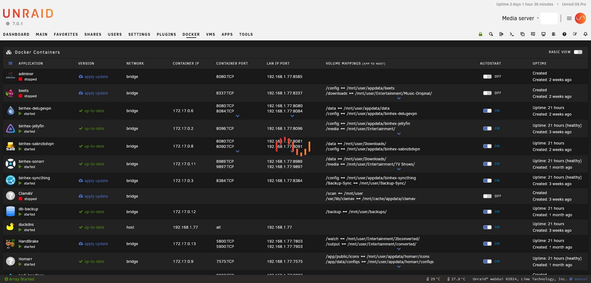

September 15, 2025Sep 15 Community Expert 6 hours ago, rockbox948 said:Docker page still refuses to load properly.On 9/12/2025 at 8:26 AM, JorgeB said:As for docker, it appears to be started. Post a screenshot from the docker page.
September 17, 2025Sep 17 Author On 9/15/2025 at 1:26 AM, JorgeB said: On 9/14/2025 at 6:35 PM, rockbox948 said: Docker page still refuses to load properly. On 9/12/2025 at 2:26 AM, JorgeB said: As for docker, it appears to be started. Post a screenshot from the docker page.lol, I missed the screenshot part.
September 19, 2025Sep 19 Author On 9/17/2025 at 1:48 AM, JorgeB said:So the issue is the Unraid logo, it keeps showing that?Correct. It continues to show the page as loading but never stops. I let it run undisturbed to see if I just wasn't patient enough. Two days later it was still doing it. With the loading screen active, I am unable to make any changes to anything on this page.

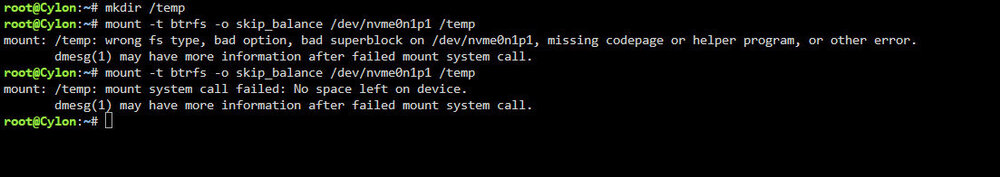

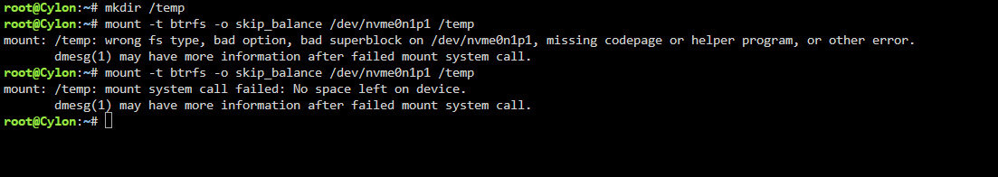

November 21, 2025Nov 21 Author @JorgeB Everything is running extremely slowly. For example, the Main window took about 2 minutes to reload and show the array drives once I stopped the array and the terminal window took about a minute and a half to load.I did the first set of commands and got this. I'm not sure if this "worked". Do I proceed with the second set? Edited November 21, 2025Nov 21 by rockbox948
November 21, 2025Nov 21 Community Expert 1 minute ago, rockbox948 said:I did the first set of commands and got this. I'm not sure if this "worked"It didn't because there's a typo; see the command above, but if it's that slow, recommend rebooting in safe mode first.
