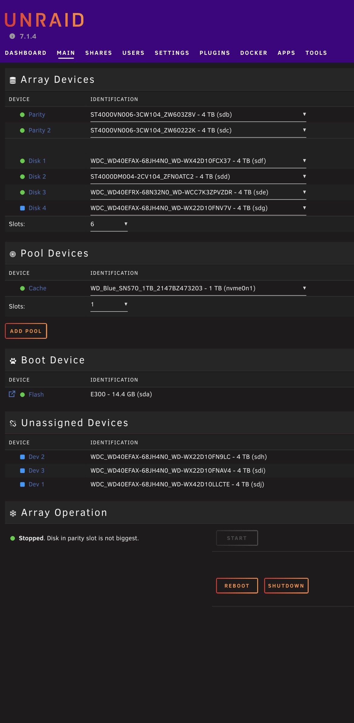

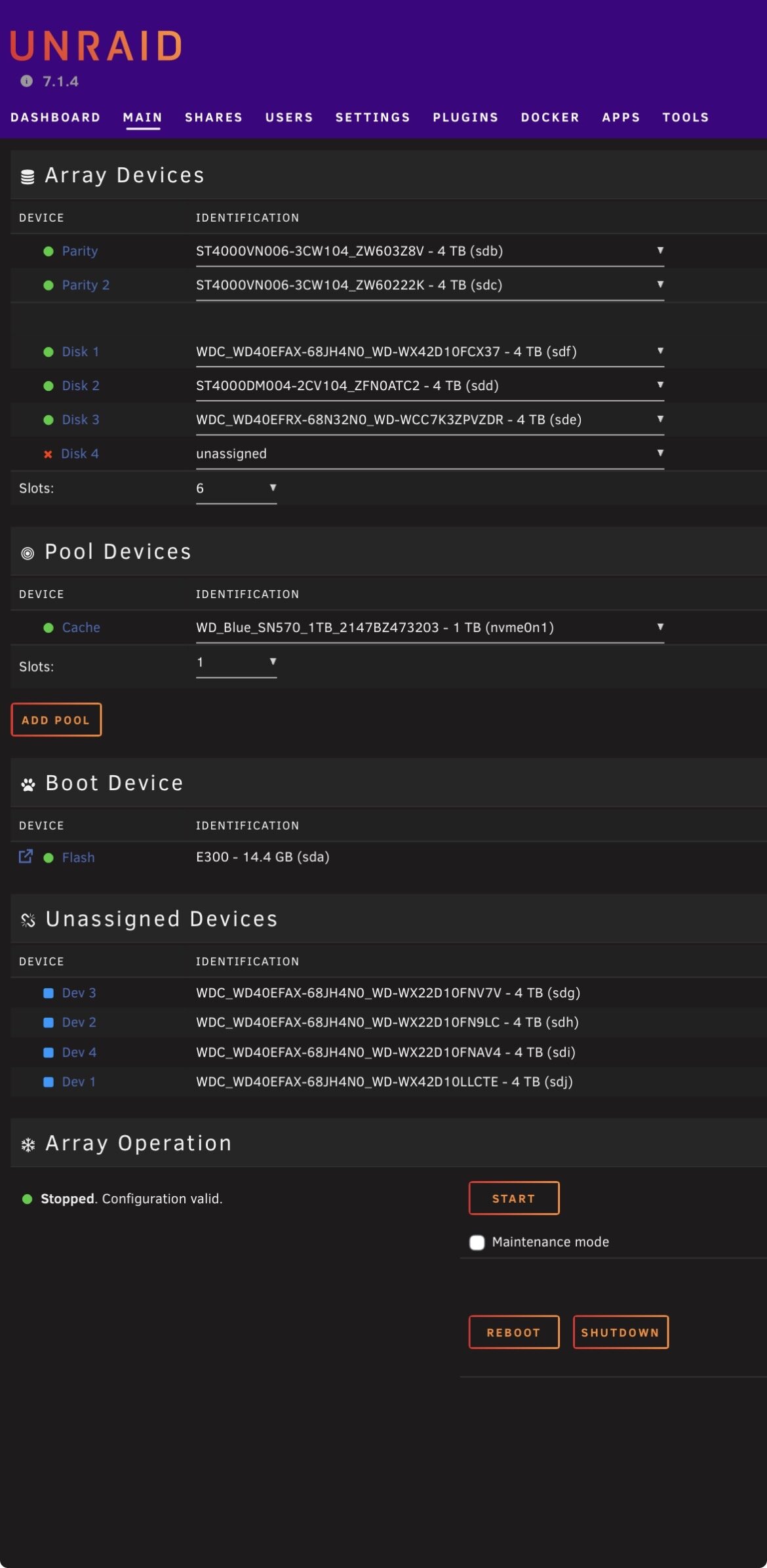

I can start the array normally, with the 4th data drive missing, but if I assign any of the new drives as a replacement for the 4tb data drive, unraid conplains:
Array Operation
Stopped. Disk in parity slot is not biggest.
What am I missing??

I think I kind of see the issue perhaps, the disks all report being 4,000,787,030,016 bytes in size, but going into the disk settings the partition shows as being
Partition size: 3,907,017,540 KB
or 4,000,785,960,960 bytes
Could this be the issue? Curiously even unassigning an existing data disk and trying to assign it to data disk 4 is triggering the issue. Also curiously, unraid does let me add the disks as new disks, just not as replacement for the 3tb disk that died.
