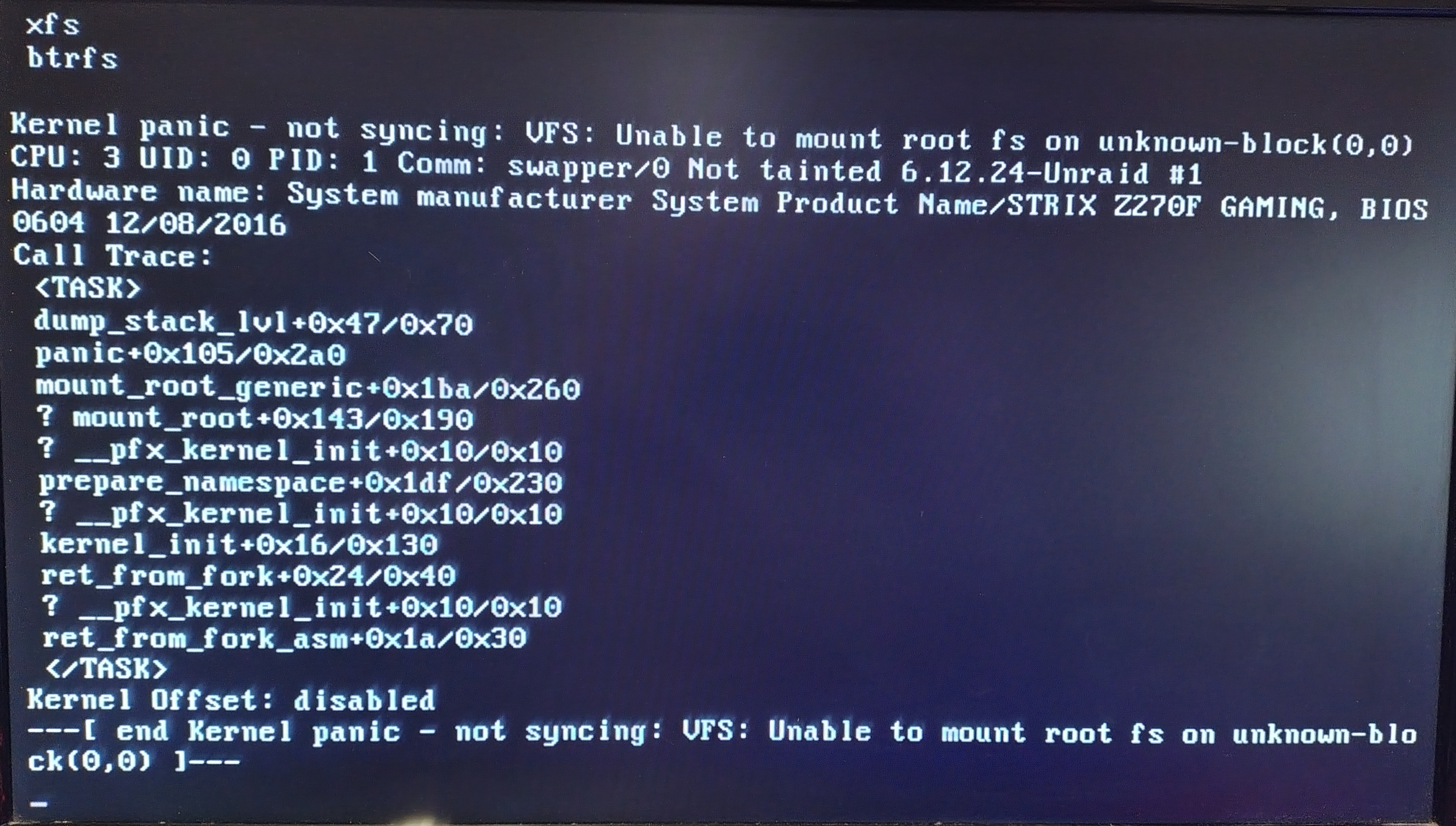

Hi folks!
I'm having this on every boot!
Please, help!
It happens when I change this in osUNRAID:
kernel /bzimage
append intel_iommu=on pcie_acs_override=downstream initrd=/bzroot
to this:
kernel /bzimage
initrd=/bzroot
I want to move back to the default
kernel /bzimage
initrd=/bzroot

Are you disabling PCIe ACS override from the GUI or manually?
@JorgeB
I've tried both...
You can try redoing the flash drive, backup the current one first and then recreate it using the USB tool and just restore the bare minimum, like the key, super.dat and the pools folder for the assignments, also copy the docker user templates folder (\config\plugins\dockerMan\templates-user), if all works you can then reconfigure the server or try restoring a few config files at a time from the backup to see if you can find the culprit.

As long as you backup the flash drive before starting, you shouldn't lose anything, and that will confirm if it's a config problem. Though before that you can try booting with a different flash drive using a stock install, no key needed; if that boots fine, it basically confirms it's config-related.

I'm making some progress giving the diagnostic files to claude.ai to analyze. However, I double-checked and when I remove the parameter "append intel_iommu=on" from the flash->unraidOS I got a "kernel panic" on the boot. I'm wondering if this is a bug in UNRAID...
What is the best way to report a bug to the staff?
You should never get a panic when removing that option, and thus booting with default settings; there's likely some config issue with your install, recommend
