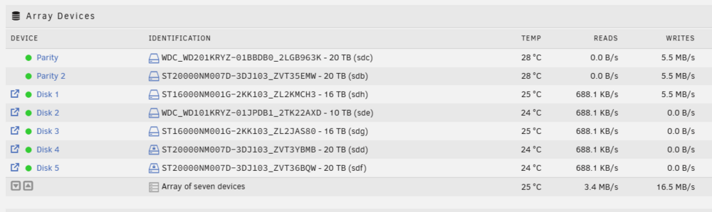

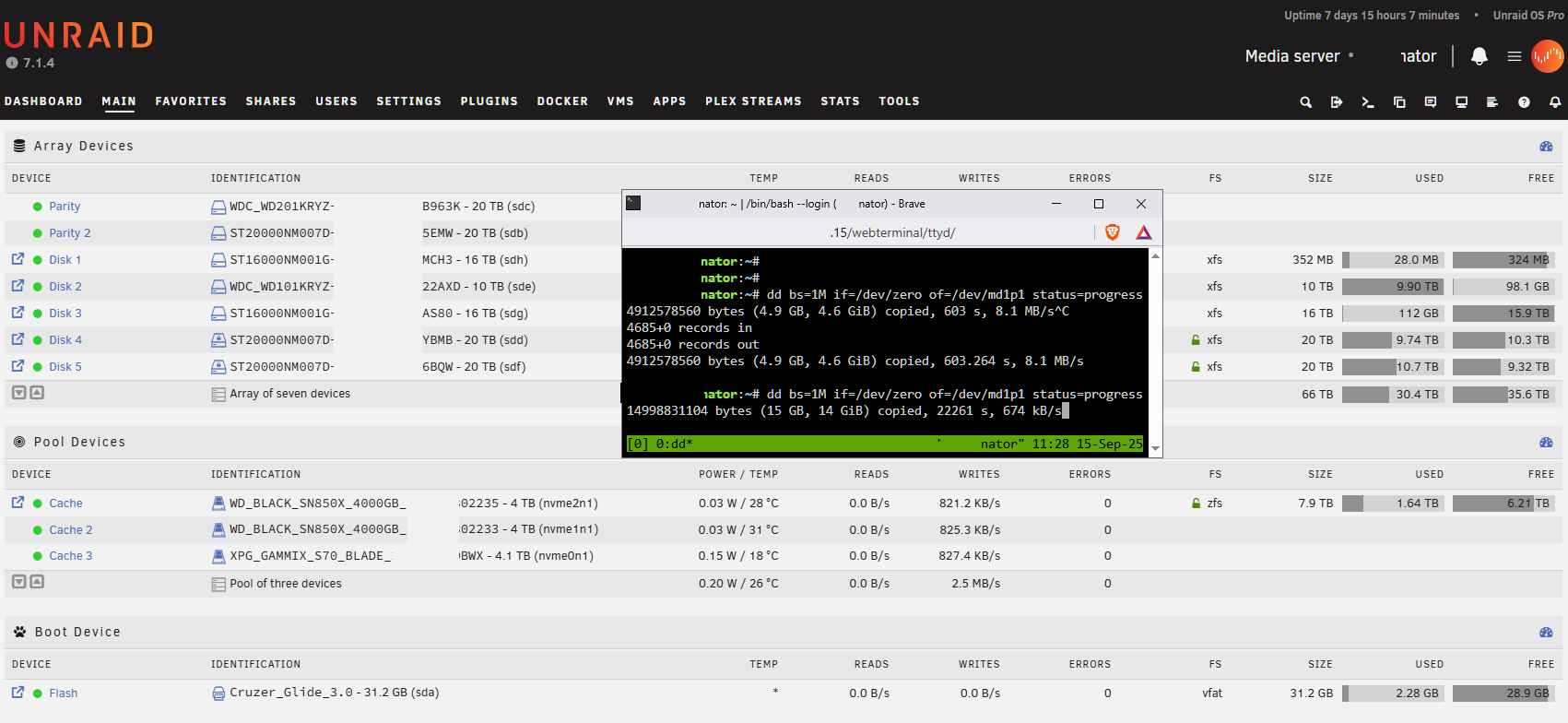

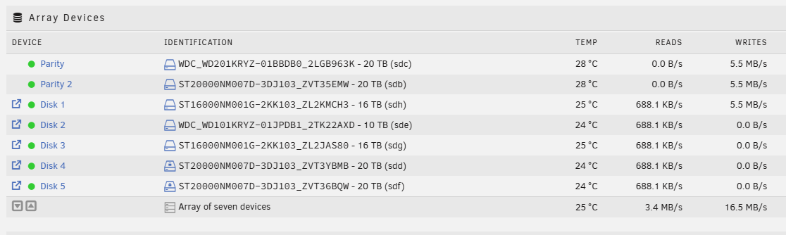

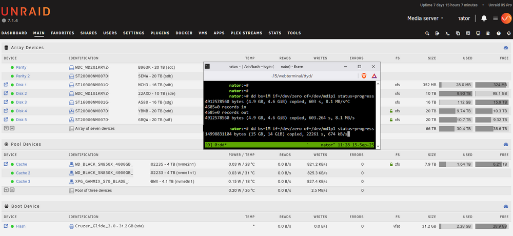

Any idea why progress is so slow?
I did this to not risk loosing parity. Though I suppose with two parity drives I can pull remove one disk at a time and keep parity regardless.
That's too slow, post the diags to see if there's anything logged there.
There are some writes going to disk2, don't appear enough to cause such a slowdown, but stop all writes temporarily and wait a few minutes to see if the speed increases.
I shutdown any dockers using the array.
Not sure what else would be writing to any array disks.
When I turn off the zero write (tried yesterday) the write speed doesn't change and array goes to idle.
Whole point was to not write parity. It looks like it's re-writing parity anyways (just super slowly). Maybe I just cancel and remove the disk and move on, hah.

It has to write to parity when zeroing out a disk, it just should not be that slow.
Ahh yes, I misunderstood/dumb moment.
Duh, it has to write parity during writing zeros to drive; It's just after that I can remove it and force a "parity is valid checkbox".
