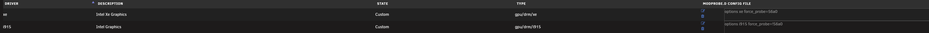

You need to stop the i915 driver binding to the device and get xe to load for it.
From lspcu you can find the info required for the force_probe.
lspci -nn | grep VGA
00:02.0 VGA compatible controller [0300]: Intel Corporation Arrow Lake-S [Intel Graphics] [8086:7d67] (rev 06)
04:00.0 VGA compatible controller [0300]: Intel Corporation DG2 [Arc A770] [8086:56a0] (rev 08)
0e:00.0 VGA compatible controller [0300]: NVIDIA Corporation TU106 [GeForce RTX 2060 Rev. A] [10de:1f08] (rev a1)
80:14.5 Non-VGA unclassified device [0000]: Intel Corporation Device [8086:7f2f] (rev 10)
in my case 56a0 for the A770
For the i915 driver you need to do
options i915 force_probe=!56a0 note ! in front of the model.
and for XE
options xe force_probe=56a0
You can add them to modprobe files via system drivers in tools as below, but change to match your device.
