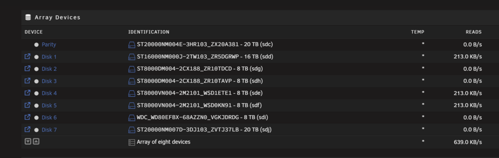

I'm at a loss. Over the last couple of weeks something keeps causing my drives to all spin up, and stay up. I've had file activity on, and unless someone is actually watching a file, nothing is showing up. I've checked everything I can think of. I've even stopped all dockers and VM's, and it still gets spun back up in just a few seconds. The amount of data being pulled is usually very small. 200kb or less, with the occasional 1MB. It also appears to pull the same amount for multiple drives at the same time, not all of the drives, but maybe 3/4 out of 7. This screenshot was taken a few seconds after I manually spun down all discs. I've also added diagnostics. Thanks in advance for your help! joshflix-diagnostics-20250915-1545.zip
