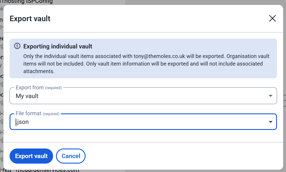

So, most importantly, is there a way to backup everything from my Bitwarden app on my PC to make sure I can restore everything in the event this is a total loss? I found File > Export Vault
Which I assume is where I need to be... but am not sure which format to use;
Also, will this back up my notes too?
