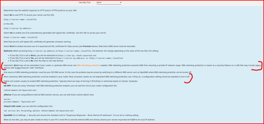

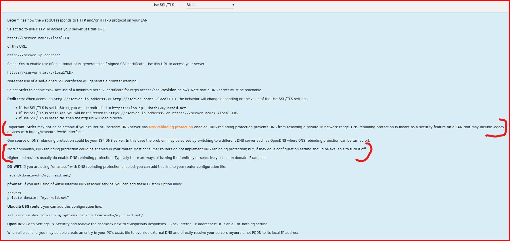

You might want to make sure that you are not getting bit by this issue:
Strict is a selectable option so that rules out the first paragraph there.
I did some digging into the DNS rebinding issue previously and my router does not have a setting for it. A user in another forum post provided a way to test if DNS rebinding is enabled by pinging a non existent unraid.net page and observing which IP it resolves to and the results were as expected for DNS rebinding to not be enabled. I also don't get the warning message about it being enabled from unraid.
Edit: this also wouldn't explain how the only variable between clients that I know of is the wired vs wireless connection.
