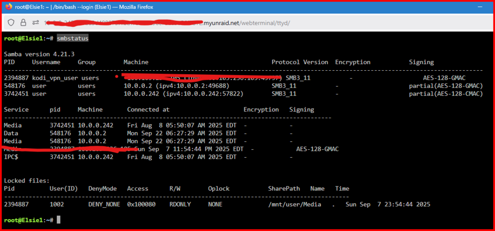

September 22, 2025Sep 22 Community Expert Using the 'Search' on the Windows taskbar. type 'command prompt' and open it upThen typeping ip_address_of_serverIf that works, tryping server_nameYou should get something that looks like this:IF you get both, Great! If not, use the one that works to access your server. (Both should work but that it determined by your router.)Now read this post:https://forums.unraid.net/topic/170027-smb-windows-settings-available-through-power-shell-and-linux-samba-tools-informational-posting/Then try this, Again in search windows, type 'power shell', right-click on it and chose "run as administrator'. Enter this command:Get-SmbConnectionWhat this command is showing is any connection that your Windows 11 computer has to any server. mine looks like this:(The two connections are the mapped drives to my server...),Now let's look at the Unraid side of the equation, open the Unraid GUI terminal and type:smbstatusOn my server I get this:You can see the names of the users connected as well as their IP addresses. (I have redacted the VPN user info...)Remember that we can only assume that you are using a standard network configuration using a typical consumer router.56 minutes ago, TopTrainer said:I notice from some of your screen shots your shares are set to Private, mine are not, do they need to be bearing in mind there is only me that has access?IT should not. (Out of precaution for security, I have set mine as 'Private'.) You say that you are the only one. What do you do when you have visitor to your house? Do you share your WiFi? If you do, you have probably just given them access to all of the files on your server! But even if you are using 'Public' for your Unraid access (Which implies that there will being users accessing using 'guest' privileges-- no login credentials required), your Windows 11 computer will (probably) require a login using user name and password to your Unraid server or it will not connect!EDIT: Give up expecting to find anything under Network in Windows File Explorer. It working seems to be a roll of the dice and expecting a '7' every time. Just 'pin' the server to the 'Quick access' and forget it is even there... Edited September 22, 2025Sep 22 by Frank1940
