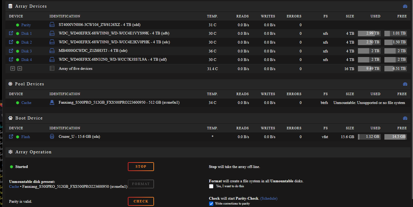

I updated UNRAID from 6.12.5 to 6.12.15 just now, and I was able to mount all disk just fine.
It randomly crashed after 30 or so minutes. After restarting the array, it now says my cache drive is Unmountable: Unsupported or no file system
I have read similar issues on the forums, but seen that same error is caused by different issues. I have attached my diagnostics if someone can help me out figure this out :)
