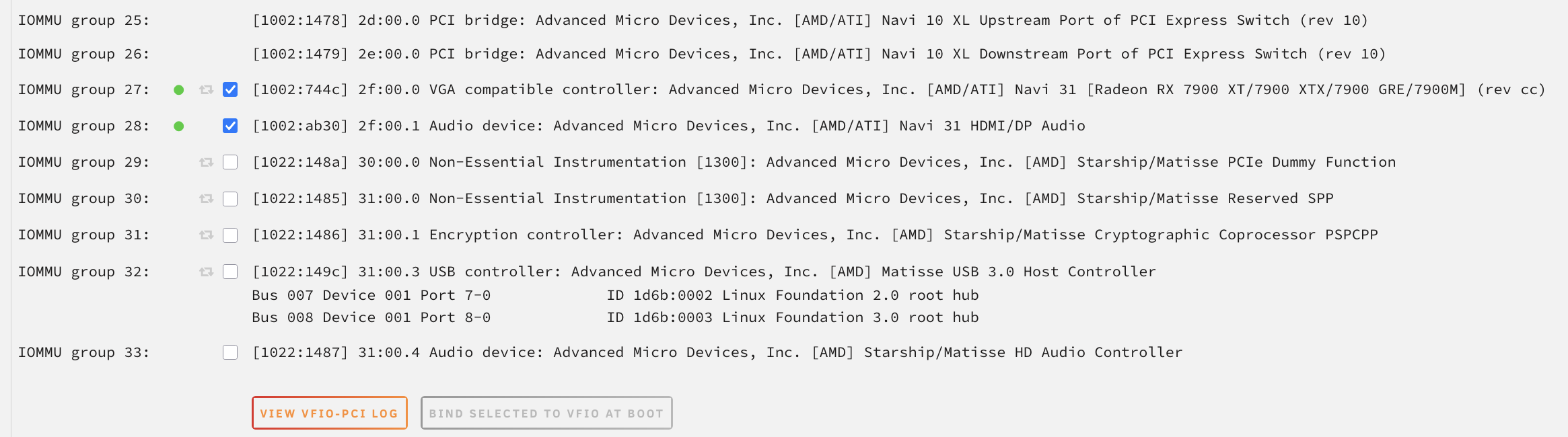

Could It be that Im not binding enough to VFIO at boot? Right now ive tried binding group 27 & 28, as well as 28-33, neither worked? What should be the correct combination ?

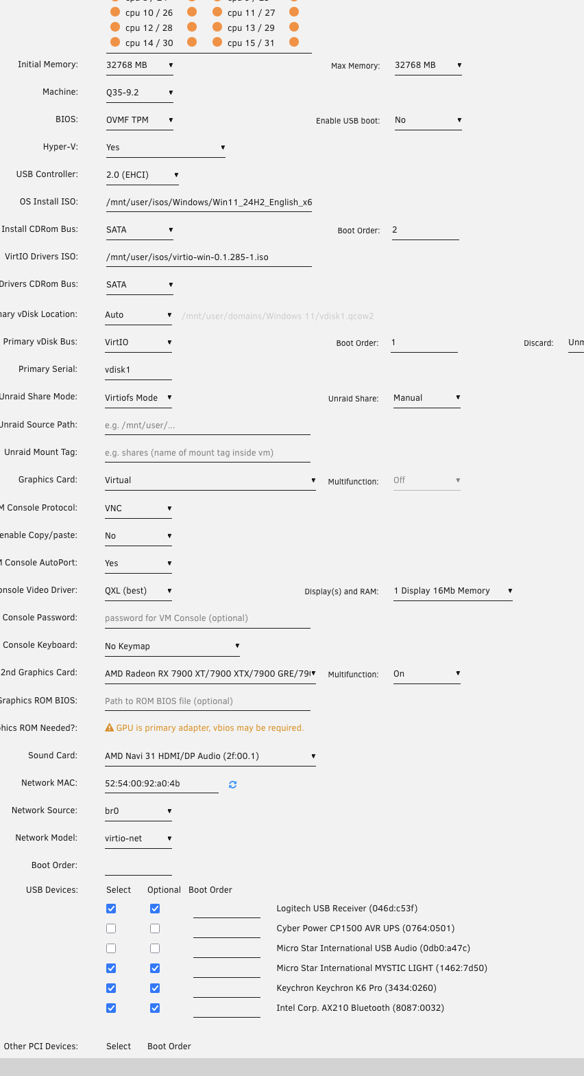

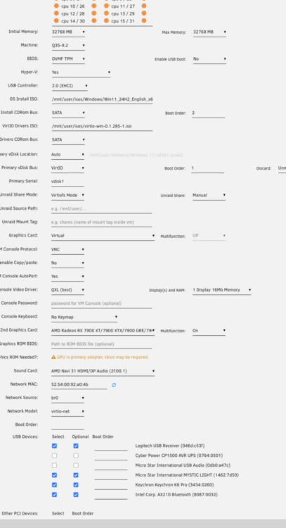

Try not to passthrough the Audio if that works.
Edit: Or try not to add the sound card in the VM settings.

I see that in your XML, your machine is Q35-9.2. Can you try changing that to i440fx? Sometimes, that fixes the problem.
