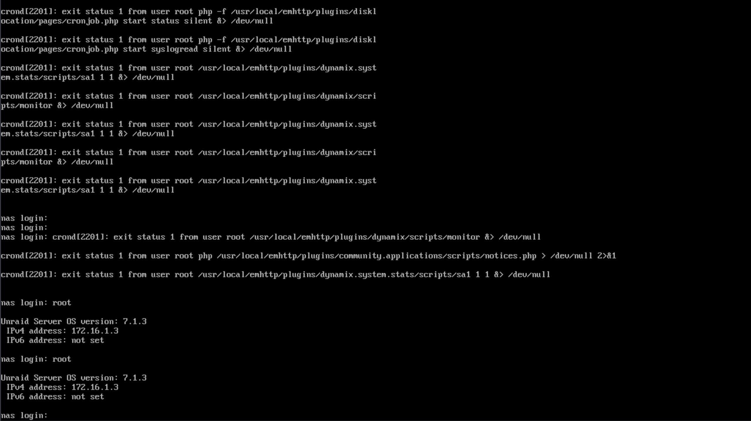

Unresponsive unraid UI , cannot even login from console?
I get a connection refused via ssh, webgui, shares.
However, even though my shares are unavailable, my docker containers seem to be working, at least some of them, including plex. But my VM's are down.
After checking my pikvm, I see this on the screen:
I can't even seem to login from the console, typing root won't take me to the pass prompt.
What could cause even the console itself fail to login?
Attached screenshot

You will likely need to force a reboot and then enable the syslog server and post that after it happens again.
was hoping to avoid an unclean shutdown but did it and the array is up again, i'll have to try to setup a syslog server. hoping it was just a random gremlin, but there were no changes made to the array. thanks
