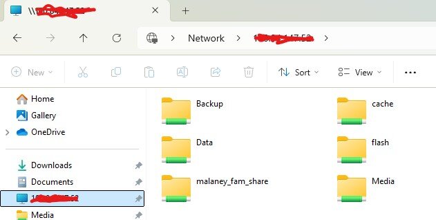

Very quick explanation. I am security conscience so I have all my shares Private.
I have set up a Share User (kodi_vpn_user) and permitted that user to only have access to the Media Share. (My choice)
I have mapped that share as a Drive on my Windows computer (Y:\ in my case) This is what I use for Kodi access since I use a common database (using the mysql Docker on the Unraid server) for all of the Media content so I only have to update and maintain a single KODI database.
I also have pinned the IP address (consider this to be the Unraid server name on Tailscale) to Windows file explorer. See Below:
With this setup, Kodi works identically as a it does on the LAN.
(I have blocked out the tailscale IP address of my Unraid server because it is a public IP address!!!)
BTW, I thought the instructions for setting Tailscale up seemed complicated when I first read them. But once I started to actually do it, it went very smoothly and everything worked the first time.
EDIT: This screenshot was actually taken off a Windows 11 client that has access to my Unraid server only via Tailscale!
